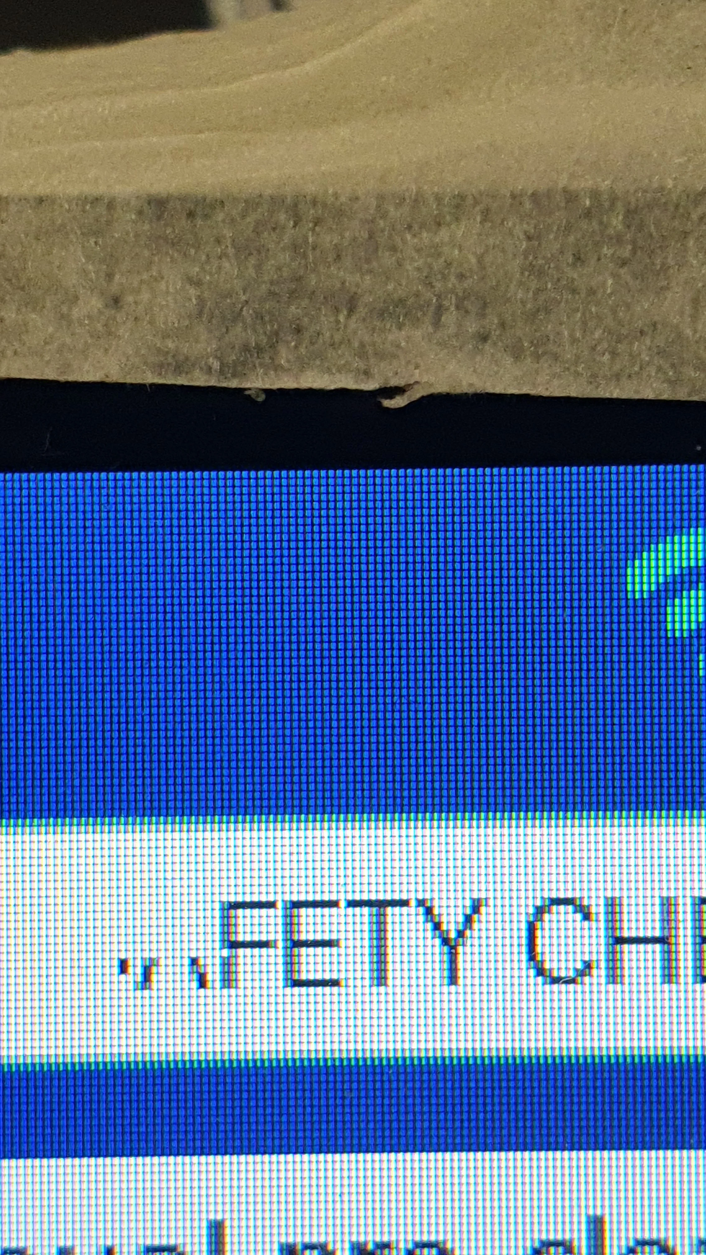

I am currently developing a product that uses a TFT display.  The product uses the following:
STM32F469ZITx
TouchGFX v4.23.2
TFT Module 320 x 240, LTDC RGB565 (16 bits), ST7272
Very often, when displaying text in a TextArea, some of the initial characters look as though they have been erased, as shown below:
The first word should read 'SAFETY'
Sometimes, this reads correctly, eg by cycling through my screens and back to this one.
All of the other items on the screens such as images, buttons, icons etc display with no problems at all.  It's just the TextAreas that are affected. The font used is Verdana, as supplied in TouchGFX.
Any help with this would be most welcome.

BTW what is this white object behind SAFETY text, it looks so unsharp and soft edge. Just think can it affect to the text also. The other object below looks very sharp.
Is there some common factor between working and non-working texts... or are all texts glicthed randomly ?.  Just some thoughts...
Br JTP

Hello @johnhague ,
Are you using the available TouchGFX Board Setup for your project or have you started a completely new project?
Are you storing your TextFlashSection inside external flash or internal one?

I only joined this project recently, so I have inherited the main code base.  However, it is a custom board, so I would assume that it was started as a completely new project. I will check when the person involved at the very start returns to the office on Monday.
As to your second question, we are only using internal flash at this moment,

Based on the point that you made about the text correctly rendered after cycling through other screen, I would suggest adding a button which on the click invalidates the corrupted TextArea. It is not a solution, it is for testing purpose to observe the behavior of what is happening.
Please try that and update us with your findings.

Can you show how you set for example this 'Safety...' text ? I mean is it wildcard buffer text or use text resources ?
Sometimes it seem to help if the text area is invalidated also before manipulating the text content especially when use some move or resizing- commands.

The 'Safety...' text is just a Text Area that has been defined in TouchGFX Designer and is fixed in nature.
Regarding your second comment, I do not manipulate this text whilst running the code.  It is set and displayed in the screen's View Base file, as:
InfoLabelSafetyChecks.setTypedText(touchgfx::TypedText(T_SAFETYCHECKSHEADING));

I see. Maybe just add some extra invalidate-calls to setupScreen function as a temporary fix (if it works then).

I have just tried again, with 4 calls to the text area's invalidate() method in the setupscreen and unfortunately I do still see the same occasional problem.

Do you use cache? In that case you need to clear the cleaninvalidate the cache.

Thanks for your input.  I do not use cache (yet) in my application, so this is not a solution, unfortunately.

Do you see the same problem in the simulator?

I don't recall seeing it in the simulator.  However, I cannot get my code to build for the simulator atm...it builds in the IDE, but not TouchGFX Designer.  That's another problem though....

The white object behind is an image taken from our marketing slides and is just a plain white background.  I will look to change this to a fiiled box, or another 'TouchGFX 'stock' object.  Thanks for the observation, as this box is used on other screens where this problem occurs.
Also, in response to your second question.  The texts do appear randomly, but all share an imported .png background.
I will investigate further and come back with my findings.
