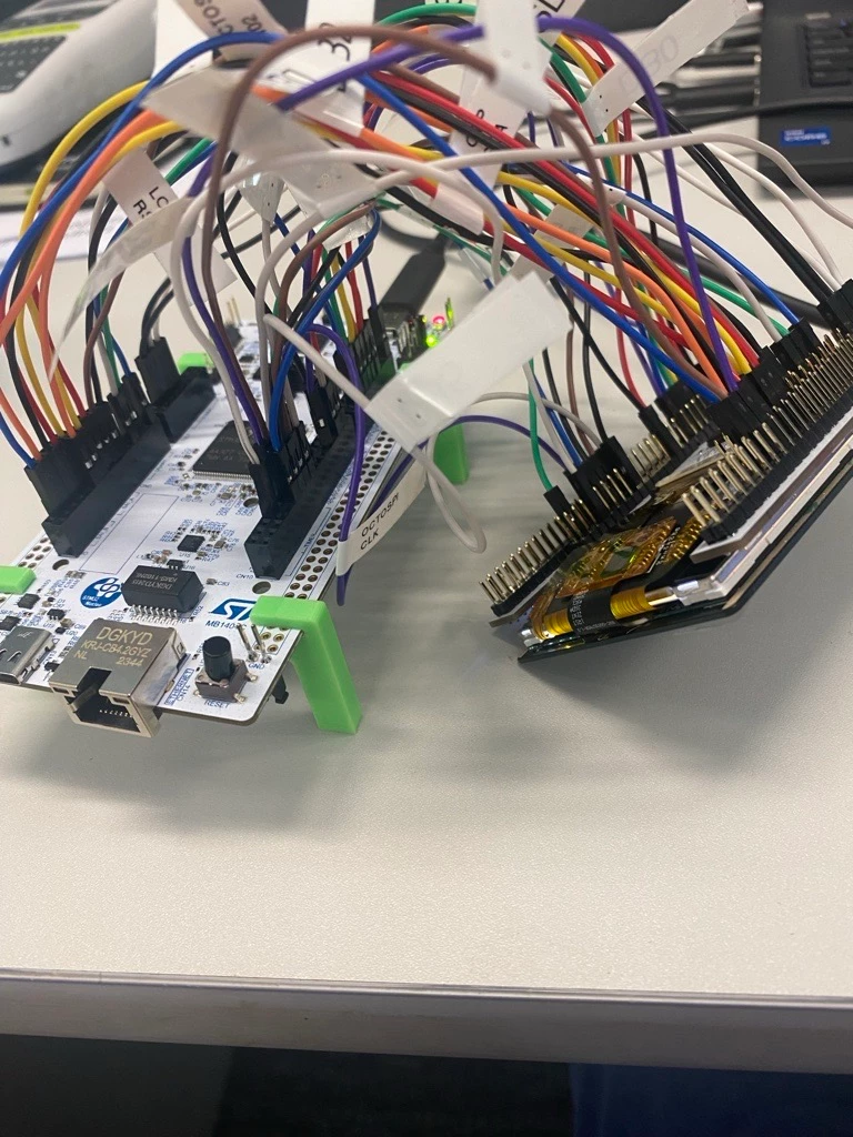

Dec 11, 2024 1:46 AM UTC
Hello @GaetanGodart @mathiasmarkussen
Behold, our creation:
How we are approaching this:
1) We decided to not change the TBS for the RVA35HI + H563ZI, rather adapt the connections off REV1.0 to match that of the expected connections for REV1.1 of the display.
2) This involved spotting the differences between the mappings of the respective versions and using female-male jumper cable connections from the display to the dev board. PS: Have attached the table we formulated for the above
3) Some key points to note is that, in the TBS generated, we could see up-to 8 Data Buses in total (ordered from DB0-DB7), whereas in the pin connections for REV1.0 of the display, there were more than 8 Data Buses attached to the connectors (CN7-CN12). What we decided to do was to simply ignore all the Data Buses after DB7 since .ioc file for the TBS expected only upto DB7. If what I have said so far is not clear, please feel free to ask for clarification :)

5) Unfortunately, we are unable to see the output on the LCD itself, it is just blank :(
Would you have any thoughts/suggestions or be able to point out where I may have gone wrong or have not considered certain things? Would really appreciate it :)

CharanVisAuthor
Dec 16, 2024 2:02 AM UTC
Thank you so much for your help @mathiasmarkussen @GaetanGodart
Got the V1.1 and it works. Saved me all the effort :)
