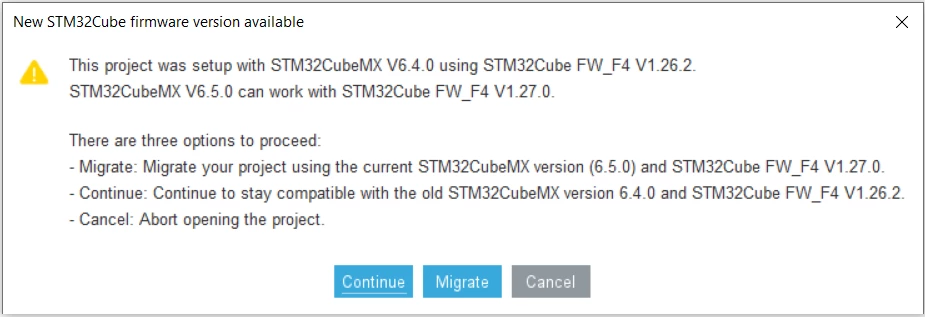

Addition: The functions seems to vanish whenever CubeMX is used to generate code (with TouchGFX Software Package 4.19.1).
Solution: Update CubeMX to 6.5.
Remark: With Designer 4.19.1 and CubeMX 6.5 the function does not vanish anymore, but the designer seems to generate CubeMX 6.4 projects: When I open the ioc-file, I have to decide whether to continue with the old version or migrate to the new one although FW 1.27 is installed.

Thanks for your post. Indeed, we encourage to use TouchGFX Designer 4.19.1 with our latest STM32CubeMX 6.5.0. That will avoid some compatibility issues like the one you had. Your solution is correct.
I'm not sure about what do you mean by "but the designer seems to generate CubeMX 6.4 projects". Actually, the generator doesn't generate anything related to CubeMX. I think your project is initially created to be compatible with an old version of CubeMX, using an old firmware. That is to say, the version of your board probably was configured using CubeMX 6.4. Generating new version of the board is a work on our table, we're going to update our boards to match with the latest firmware. I'll get back to you when I'll have more info about this subject.
In meantime, yes, you can use "Migrate" to use the latest firmware.

When you create a new TouchGFX project with the TouchGFX designer (for STM32429I-EVAL in my case), an ioc-file is created. This, of course, belongs to CubeMX, not to the Designer, but the Designer has to somehow tell CubeMX what to do. I just wondered why I got the Migration-request, as everything now seems up to date.
Now I'm not sure about what you mean by "generating new version of the board": Is it about the board itself or the "representation" of the board in TouchGFX Designer oder CubeMX?
