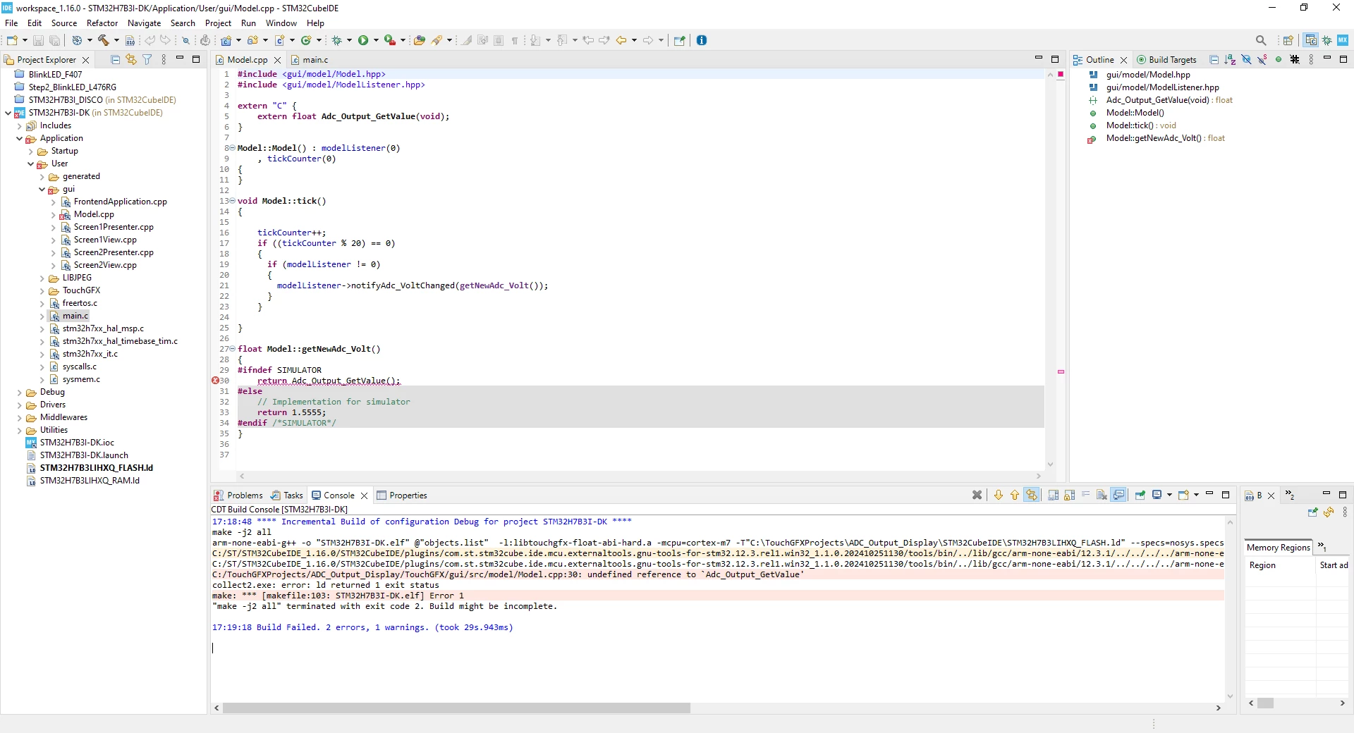

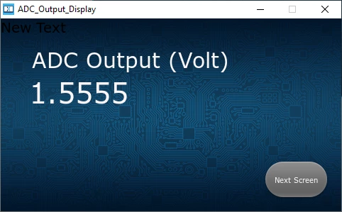

The project can display a float constant (the 1.5555) in the Simulator on TouchGFX (refer to Model.cpp file), but in STM32CubeIDE, there are 2 build errors as show below (As a result, unable to show the float constant from main.c on the screen.):
(Copy from the Console of STM32CubeIDE after build):
C:/TouchGFXProjects/ADC_Output_Display/TouchGFX/gui/src/model/Model.cpp:30: undefined reference to `Adc_Output_GetValue'
collect2.exe: error: ld returned 1 exit status
make: *** [makefile:103: STM32H7B3I-DK.elf] Error 1
"make -j2 all" terminated with exit code 2. Build might be incomplete.
17:19:18 Build Failed. 2 errors, 1 warnings. (took 29s.943ms)
The Adc_Output_GetValue() has already been defined both in Model.cpp and main.c; so not sure what means the: undefined reference to ‘Adc_Output_GetValue’; and do not know what to do next.
Also do not understand the meaning of:
Could you please provide your advice, and suggestion about what to do?

Simulator result:
STM32CubeIDE Build Results (below 2):

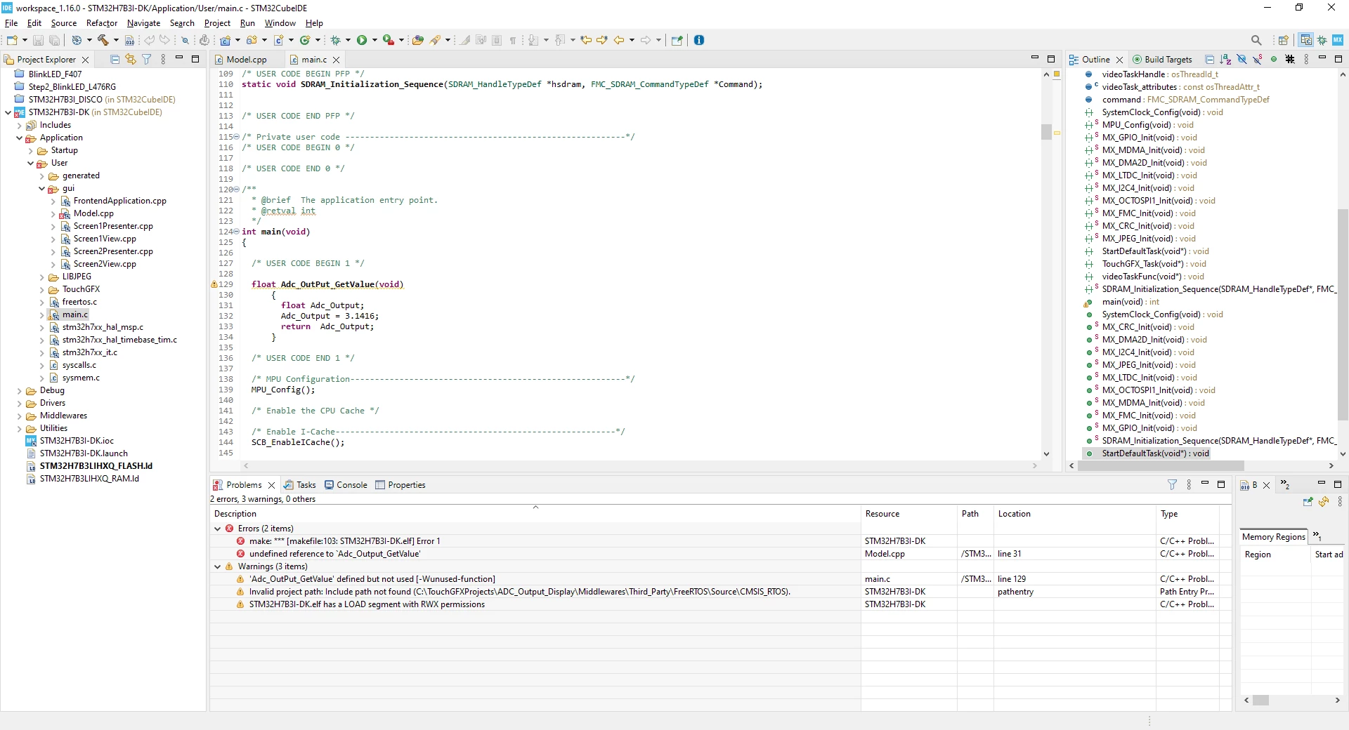

Do you have the actual function defined in main.c? All I can see from what you posted is a declaration.
EDIT. Actually I see the problem from your main.c, you need to move your function definition to outside of main().
You have it defined in the while(1) loop, which is the wrong place. Put the definition outside of main and it should at least build, you can also remove the HAL_Delay:
float Adc_OutPut_GetValue(void);
 return 3.1416;

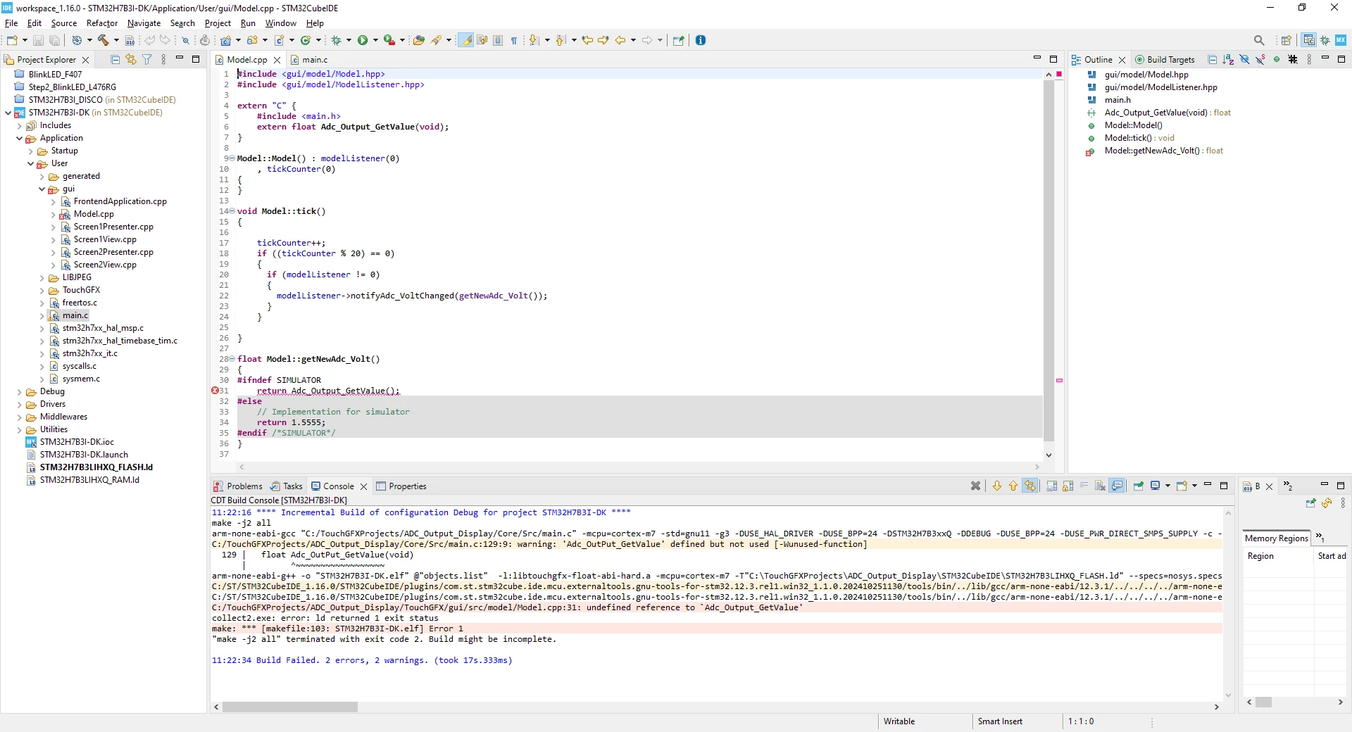

and have moved the function out of the while(1) loop, first place it under /* USER CODE BEGIN 5 */ not working, then place the function under /* USER CODE BEGIN 1 */ inside int main(void); it still can not build. Getting the similar build errors from STM32CubeIDE:
C:/TouchGFXProjects/ADC_Output_Display/Core/Src/main.c:129:9: warning: 'Adc_OutPut_GetValue' defined but not used [-Wunused-function]
129 | float Adc_OutPut_GetValue(void)
C:/TouchGFXProjects/ADC_Output_Display/TouchGFX/gui/src/model/Model.cpp:31: undefined reference to `Adc_Output_GetValue'
11:22:34 Build Failed. 2 errors, 2 warnings. (took 17s.333ms)
Below the two print screens from STM32CubeIDE:
Enclosed also Model.cpp (as shown below) and the main.c as an attachment.

AMars.4
Jan 31, 2025 2:10 AM UTC
Your function is still in the wrong place, it needs to be outside of the main function.
Place it in the /* USER CODE BEGIN 0 */ section.

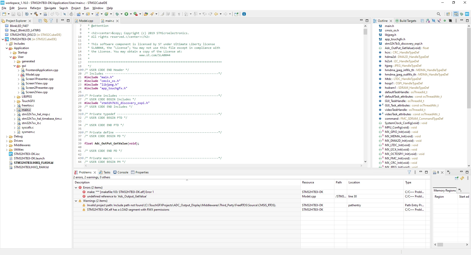

EY1Author
Feb 1, 2025 12:11 AM UTC
Thank you AMars.4 for your reply.

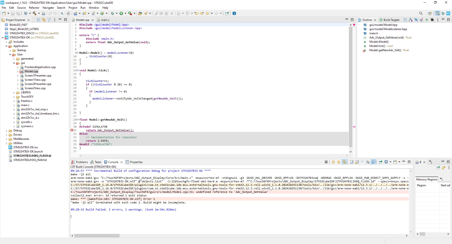

I have placed the function under the /* USER CODE BEGIN 0 */ in main.c
The Model.cpp remains the same (unchanged).
In the build results, "the warning for main.c 'Adc_OutPut_GetValue' defined but not used" disappear; thank you.
The current STM32CubeIDC build results:
09:28:32 Build Failed. 2 errors, 1 warnings. (took 1m:34s.826ms)
and the print screen:
The build error, Model.cpp:31: undefined reference to `Adc_Output_GetValue' is still remained.
Not sure how to overcome this.
Enclosed also the updated main.c
Thank you very much for your time and support. I look forward to hearing your advice.
