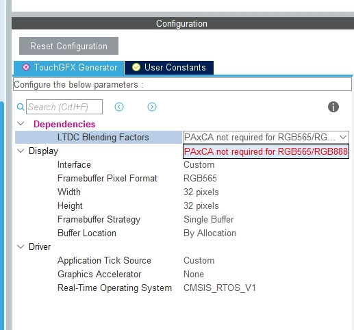

Well..yes I do have watched the videos several times etc. I know this must probably seem trivial to you and I apologize for my noobness as I still can't get this working. Like I said I can make the measurements and get the results. Also, I can make a very nice GUI with TouchGFX, but integrating these two is a major p.i.t.a. I made another test GUI with 1 screen and a textArea with wildcard value. I can run it in the target (stm32f469-disc) with no problems. When I generate the same GUI through CubeIDE (or CubeMx..same thing) it compiles, but the screen is blank. I checked and compared the BoardConfiguration.cpp files. They are very much different. Cubemx version is missing a ton and has 135 lines of code versus TouchGFX version which has 576 lines. Why? Now if I could get the correct settings for my board I might actually be able to start testing.
HHarj.1
HHarj.1Author
January 8, 2020
Downloaded the new versions of CubeIDE, CubeMx, and TouchGFX. Didn't solve anything. One might assume that selecting a board from supported boards with default settings would provide the correct initial settings for the LCD display, but no. I am repeating myself, but does anyone know the correct display settings for stm32f469 disco board? 0690X00000BvlNZQAZ.jpg

It has never been the intention of CubeMX to configure anything related to BSP (LCD gpios, qspi memory mapped mode, sdram timings, etc).
Why don't you try using the application templates from TouchGFX Designer? They're good to go with everything set up.
We're working on upgrading all Application templates to version 3.0 which will support CubeMX 5.5 and TouchGFX Generator. It's a pretty big task, but we're working on it. So far there's F746G-DISCO and H7B3I-DK.
If you don't need to reconfigure anything related to hardware you can just use the ATs from the designer, even the F469 (which isn't upgraded to 3.0/CubeMX 5.5.0 yet)
