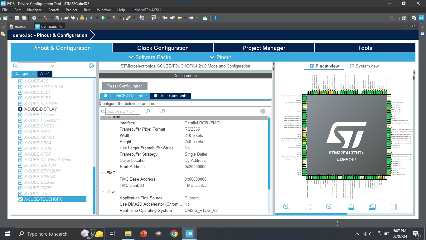

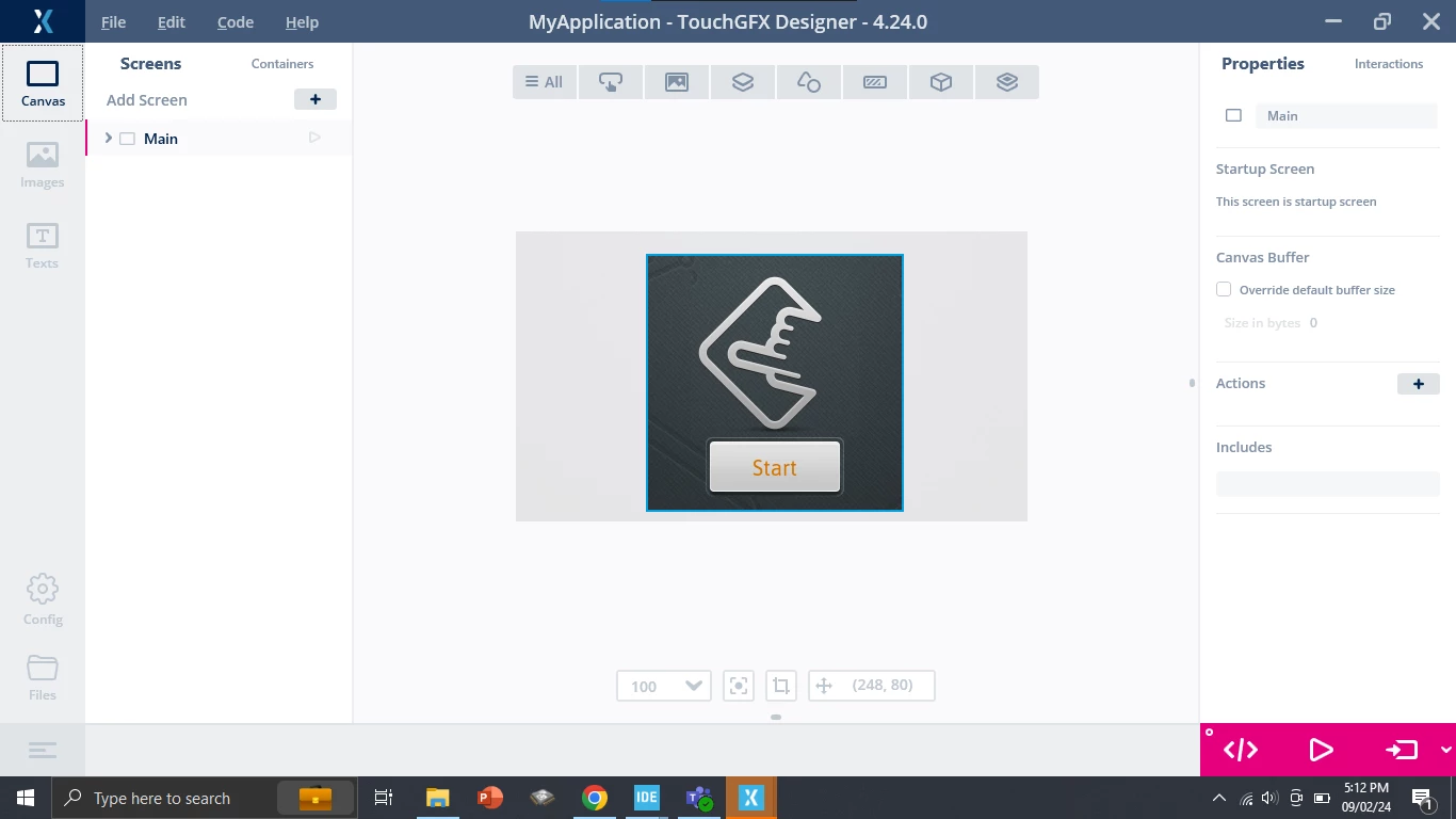

Sep 2, 2024 11:45 AM UTC
Thanks for your quick reply @GaetanGodart
I already watched that video https://youtu.be/SRQD8JMeg_k?si=oWqNTiEddbzsl_pj
Here, STM32F413ZHT6 does not have LTDC. So I'm using FSMC as a LCD interface.
I create a TouchGFX project via STM32CubeIDE-> TouchGFX-> ApplicationTemplate.touchgfx.part
Then I created an example project.
Then I run a TouchGFX project and refresh it. After compile successfully. In between that where I put a LCD initialization code?

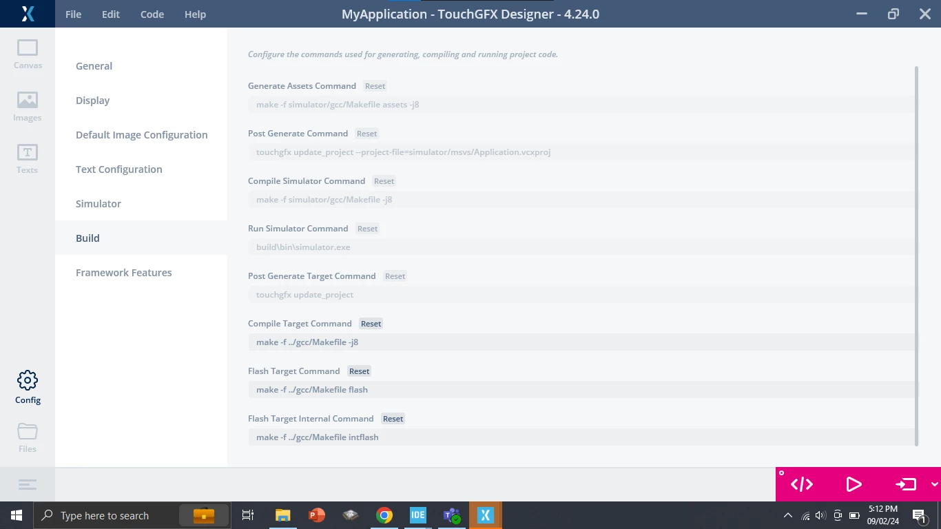

Sep 2, 2024 11:52 AM UTC
When I enter the Program and run target. I got failed message.
Like:
Program and Run Target
 Generate
 Done
 Generate Assets
 make -f simulator/gcc/Makefile assets -j8
 Reading ./application.config
 Reading ./target.config
 Done
 Post Generate
 touchgfx update_project --project-file=simulator/msvs/Application.vcxproj
 Done
 Post Generate Target
 Writing STM32CubeIDE project file: ../.cproject
 Done
 Compile
 make -f ../gcc/Makefile -j8
 make: ../gcc/Makefile: No such file or directory
 make: *** No rule to make target '../gcc/Makefile'. Stop.
 Failed
 Failed

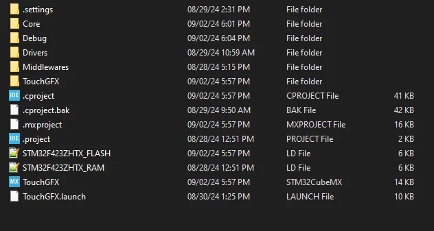

GaetanGodart
Sep 2, 2024 12:01 PM UTC
No problem! :smiling_face_with_smiling_eyes:
The error happens during compilation.
Apparently, there is no Makefile.
Can you check that you have a Makefile in the gcc fodler?
If you don't, you should create one (you can get very inspired by the ones we created for boards similar to yours).
Regards,
Gaetan GodartSoftware engineer at ST (TouchGFX)

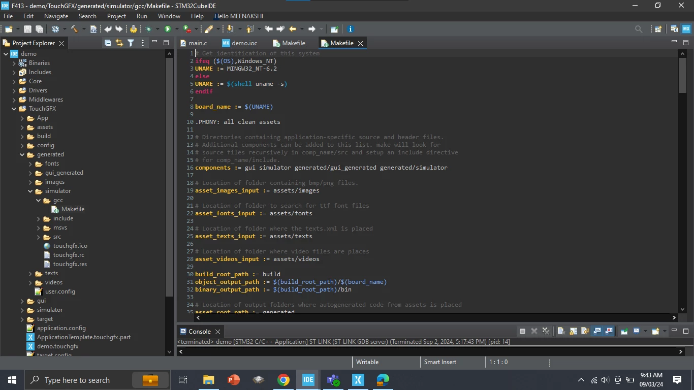

GaetanGodart
Sep 2, 2024 1:32 PM UTC
This make file seems to only be good to run the simulator as it seems to call "make generated/simulator/gcc/Makefile".
I could be wrong though.
Do you have a Mafekile in generated/simulator/gcc?
Sep 3, 2024 4:44 AM UTC
Yes, I've Makefile in generated/simulator/gcc

	@rm -f $(build_root_path)/objects.tmp
	# Remove old images
	@rm -f $(binary_output_path)/*.bin
	@if ls $(asset_videos_output)/bin/*.bin >/dev/null 2>&1; then cp $(asset_videos_output)/bin/*.bin $(binary_output_path); fi
ifneq ($(UNAME), Linux)
	@if [ ! -f $(binary_output_path)/SDL2.dll ]; then cp $(sdl_library_path)/SDL2.dll $(binary_output_path); fi
	@if [ ! -f $(binary_output_path)/SDL2_image.dll ]; then cp $(sdl_library_path)/SDL2_image.dll $(binary_output_path); fi
	@if [ ! -f $(binary_output_path)/libpng16-16.dll ]; then cp $(sdl_library_path)/libpng16-16.dll $(binary_output_path); fi
	@if [ ! -f $(binary_output_path)/zlib1.dll ]; then cp $(sdl_library_path)/zlib1.dll $(binary_output_path); fi
	@if [ ! -f $(binary_output_path)/libjpeg-8.dll ]; then cp $(jpeg_library_path)/libjpeg-8.dll $(binary_output_path); fi
endif
.PHONY: post_build
post_build:
	@mkdir -p $(binary_output_path)
	@if [ -f simulator/landscape.png ]; then cp simulator/landscape.png $(binary_output_path); else rm -f $(binary_output_path)/landscape.png; fi
	@if [ -f simulator/portrait.png ]; then cp simulator/portrait.png $(binary_output_path); else rm -f $(binary_output_path)/portrait.png; fi
$(object_output_path)/touchgfx/%.o: $(touchgfx_path)/%.cpp config/gcc/app.mk
	@echo Compiling $<
	@mkdir -p $(@D)
	@$(cpp_compiler) \
		-MMD -MP $(cpp_compiler_options) $(cpp_compiler_options_local) $(user_cflags) \
		$(patsubst %,-I%,$(include_paths)) \
		-c $< -o $@
$(object_output_path)/%.o: %.cpp config/gcc/app.mk
	@echo Compiling $<
	@mkdir -p $(@D)
	@$(cpp_compiler) \
		-c $< -o $@
$(object_output_path)/%.o: %.c config/gcc/app.mk
	@echo Compiling $<
	@mkdir -p $(@D)
	@$(c_compiler) \
		-MMD -MP $(c_compiler_options) $(c_compiler_options_local) $(user_cflags) \
		-c $< -o $@
ifeq ($(MAKECMDGOALS),build_executable)
$(firstword $(dependency_files)): config/gcc/app.mk
	@rm -rf $(object_output_path)
-include $(dependency_files)
endif
assets: images texts videos
.PHONY: images
images:
	@$(imageconvert_executable) -r $(asset_images_input) -w $(asset_images_output)
.PHONY: texts
texts:
	@ruby $(textconvert_script_path)/main.rb $(text_database) $(fontconvert_executable) $(asset_fonts_output) $(asset_texts_output) $(asset_fonts_input) .
.PHONY: videos
videos:
	@ruby $(videoconvert_script_path)/videoconvert.rb $(asset_videos_input) $(asset_videos_output)
clean:
	@echo Cleaning
	@rm -rf $(build_root_path)
	# Do not remove gui_generated
	@rm -rf $(asset_images_output)
	@rm -rf $(asset_fonts_output)
	@rm -rf $(asset_texts_output)
	@rm -rf $(asset_videos_output)
	# Create directory to avoid error if it does not exist
	@mkdir -p $(asset_root_path)
	# Remove assets folder if it is empty (i.e. no gui_generated folder)
	@rmdir --ignore-fail-on-non-empty $(asset_root_path)
GaetanGodart
Sep 3, 2024 8:30 AM UTC
Hello @Marudhupandian ,
Are you sure that you have a gcc folder and a Makefile in it?
When I look at your screenshots, I see that you have the TouchGFX folder but I do not see the gcc folder.
The TouchGFX and gcc folder should be at the same level :
Can you double check that please?
Regards,
Sep 3, 2024 10:06 AM UTC
Hi @GaetanGodart
You are correct. I don't have gcc file. How to make gcc file.
What is the next step to complete my project? How can I do to turn on my LCD display?
