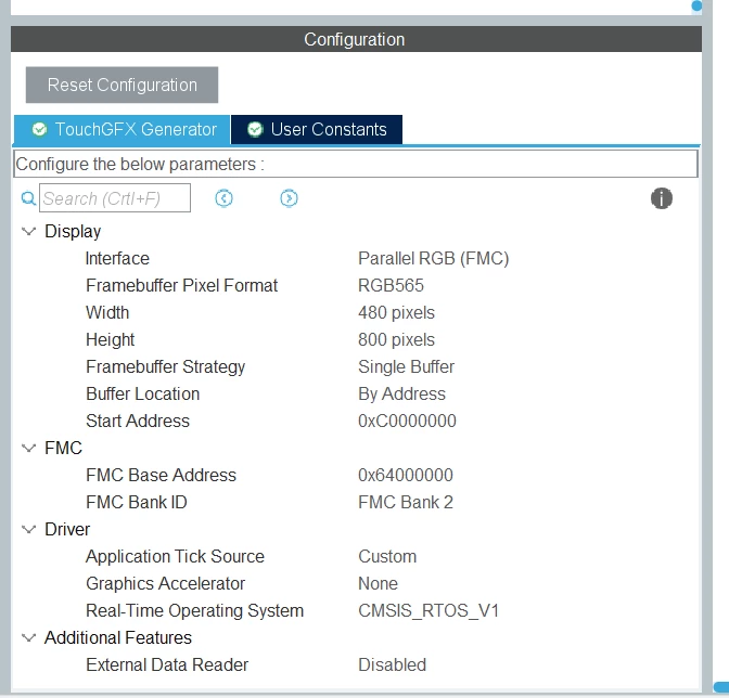

MX congiuration:

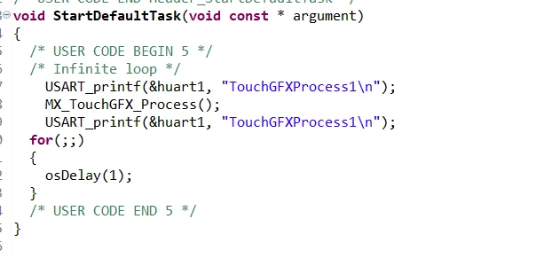

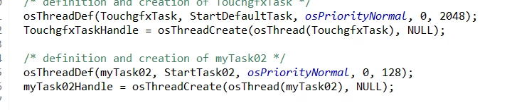

0693W00000D1TulQAF.pngFreeRTOS task:

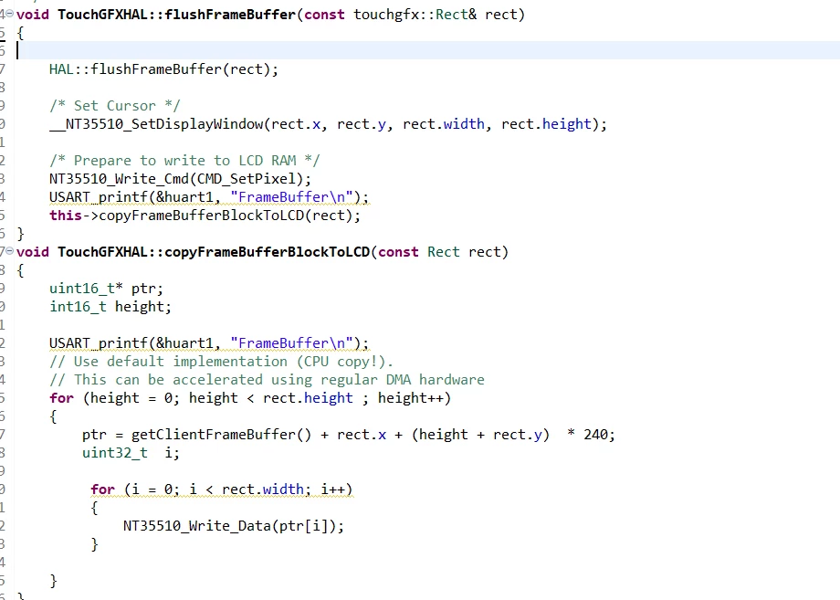

0693W00000D1TvjQAF.png0693W00000D1TveQAF.png0693W00000D1TtCQAV.pngXHAL:
0693W00000D1TwcQAF.pngresult:

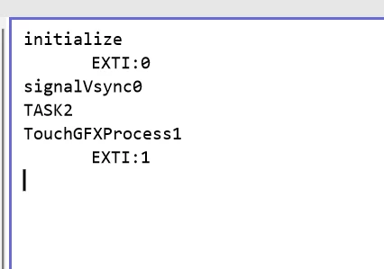

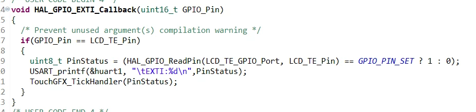

because my custom board not have the Tearing Effect PIN,so I connectec a 10Hz square wave
when the Semaphore is released.the os is blocking
