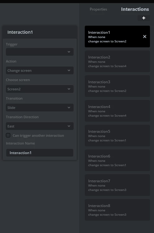

You can easily get all transition functions generated to FrontendApplicationBase.cpp by just adding empty interactions to some of your screens like
Remember to add all necessary transitions. Then you can trigger a transition from view by calling function like:
application().gotoScreen2ScreenSlideTransitionEast();

Hello @ATank.1,
When you create an interaction in designer, you can select a change screen interaction with a slide transition.
You can refer to the examples or demos in designer.
Regards,

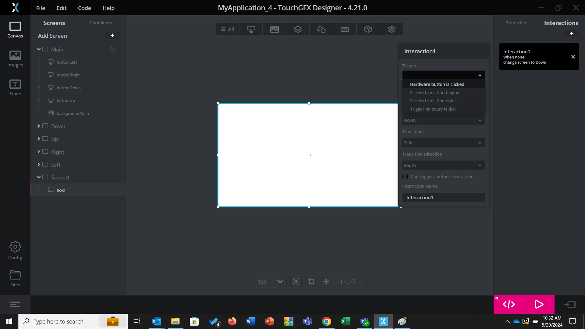

May 29, 2024 5:24 AM UTC
Is this available in the latest TouchGFX version? we are using 4.21.00
How the trigger is detected i.e user has performed slide from top to bottom or right to left?. Can this be done using the touchGFX designer itself using interaction section or we need to write code?
Please see attached image
Thanks
Anuj
May 29, 2024 9:34 AM UTC
Hello @ATank.1 ,
You have first to put a trigger (button click), and an action to it.
In action chose change screen then you will have the option to change the transition.
I highly recommend you to do the tutorial and read the documentation : TouchGFX Documentation | TouchGFX Documentation and the tutorials Tutorials | TouchGFX Documentation.
