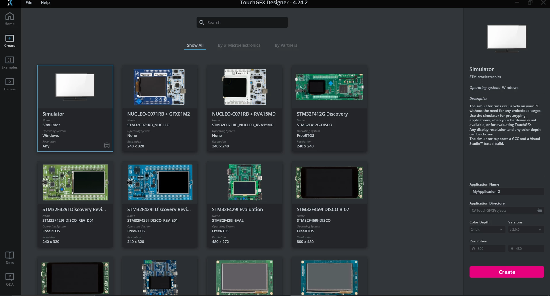

I created a new project I didn't even choose a board I tried it with the "Simulator"
I want to try some ui designs in TouchGFX. I created a new project in Simulator type:

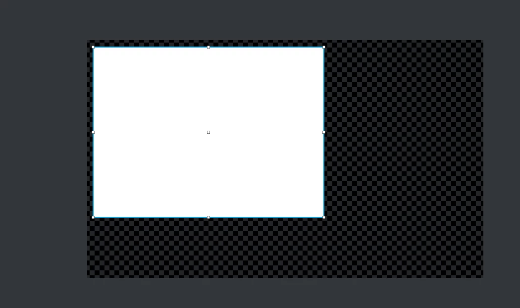

I just added a white box:

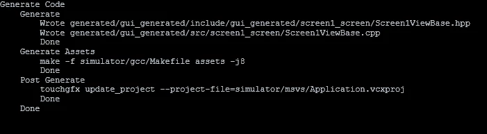

I generated code:
Generate Code
 Generate
 Wrote generated/gui_generated/include/gui_generated/screen1_screen/Screen1ViewBase.hpp
 Wrote generated/gui_generated/src/screen1_screen/Screen1ViewBase.cpp
 Done
 Generate Assets
 make -f simulator/gcc/Makefile assets -j8
 Done
 Post Generate
 touchgfx update_project --project-file=simulator/msvs/Application.vcxproj
 Done
 Done

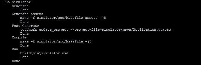

I clicked "Run Simulator":
Run Simulator
 Generate
 Done
 Generate Assets
 Done
 Post Generate
 Done
 Compile
 make -f simulator/gcc/Makefile -j8
 Done
 Run
 build\bin\simulator.exe
 Done
 Done
I tried to search for simulator.exe file in my project directory, but the file is not exist. I'm using 4.24.2 version now.
Since there is no error. I'm lost on debugging. Thx for help.

Of course. I want to try some ui designs in TouchGFX. I created a new project in Simulator type:

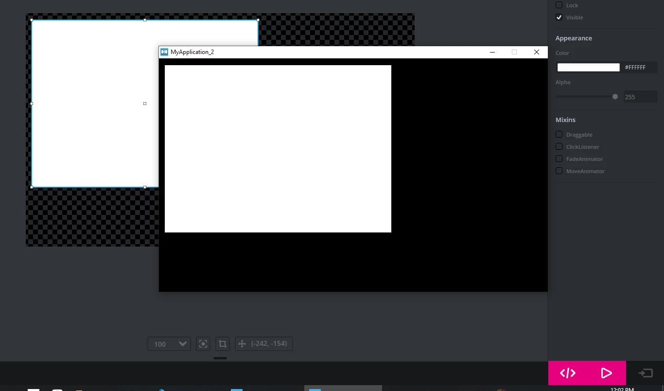

hii @barisubasi  i created same simmulation as you tried.
1. i created project : i selected simulator and clicked on creat button.
2. i created gui box:
3. i generated and clicked on run simulator button. and then simulator screen popuped:
so this way you can  simulate GUI on touchgfx. on clicking on RUN button you wont get any kindof exe file.

Did the same thing. It didn't worked. I opened TouchGFX 4.22.1 Environment and tried the same commands in the output in Designer and it worked. But the commands are not working in the Designer. Also it doesn't give any errors at all...

Works fine here with version 4.24.1 in Windows 11.
  1. Create project, I named it community_test
  2. create white box
  3. click Run
Project runs in popup.
It also creates an exe file: C:\TouchGFXProjects\community_test\build\bin\simulator.exe
