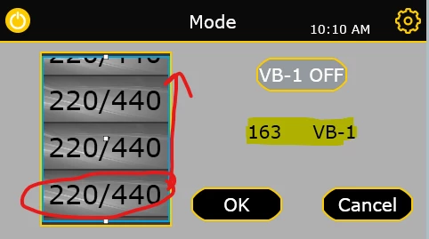

During debugging, I noticed my value for swiping down to decrement by 1 but swiping up increments by 1 twice initially. The function scrollWheelModeUpdateCenterItem(), which references itemIndex, is called twice when swiping up for after entering the screen or after swiping down.
0693W000008yw5aQAA.pngNote: values in the scroll wheel are wildcard placeholders. The expected behavior is the string highlighted is supposed to match the center item in the scroll wheel. The text of the center item and my string match when swiping down. However, the string using the ViewBase index will be the next item in the scroll wheel.

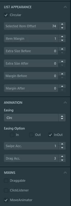

My Scroll Wheel animation and list appearance
0693W000008yw5fQAA.pngThe project is programmed onto a STM32429I-EVAL
