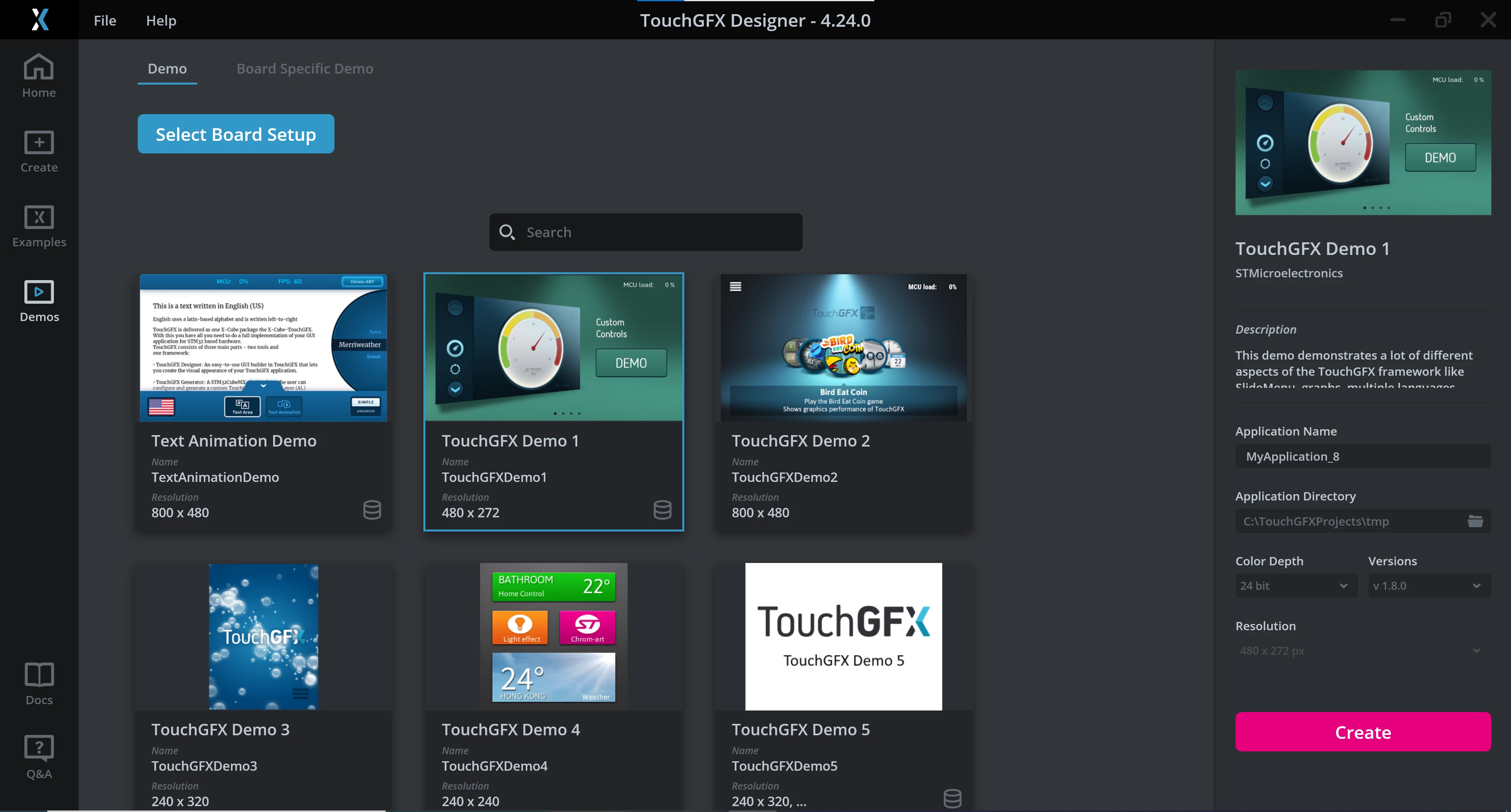

I see the asynchrony between the scrolling by the user and the demo in the Enter Calls section. Instead of using Scrollable Container, I suggest using Scroll Wheel that allows you to set a template for selected item. Therefore, you don't need to animate the items manually each time scrolling happens.
You can see how it can be used inside a number of demos available in the TouchGFX Designer like TouchGFX Demo 1:
TouchGFX Demo 1TouchGFX Demo 1
Or use the widgets shared by community members here.
