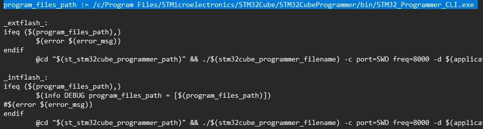

The first one is adding the path as a static value in first line of flash_sections_int_ext.mk:

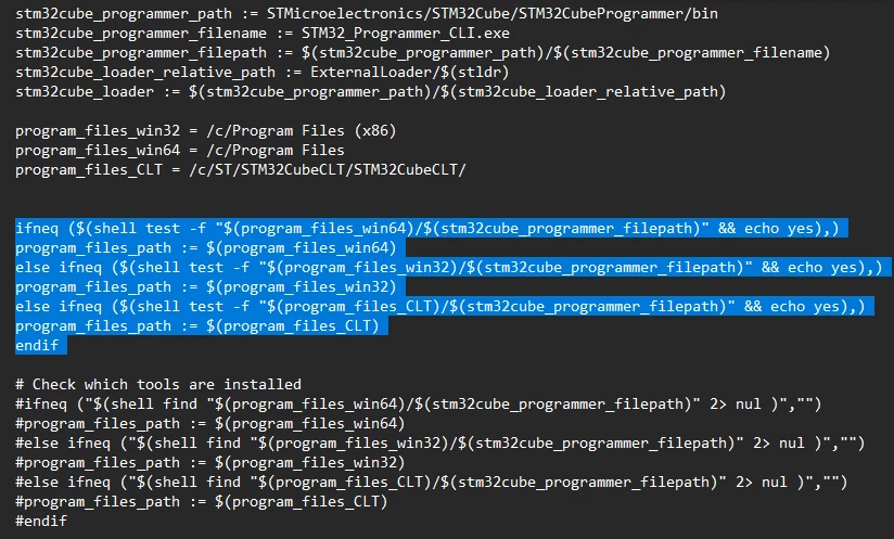

The second one is modifying the syntaxe of the auto-path detection in cube_programmer.mk:
cube_programmer.mk
