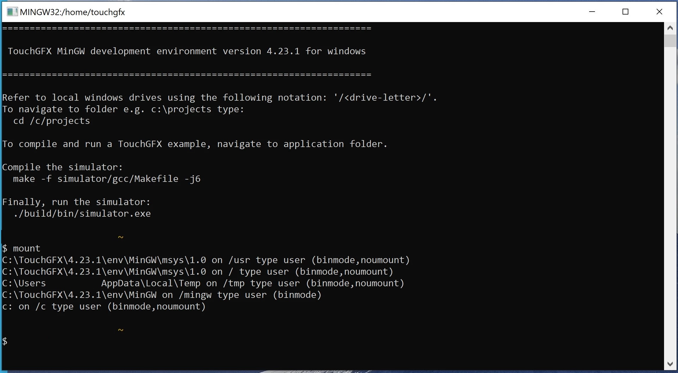

    Plus, it would be nice if you can provide the TouchGFX log that is available at AppData/Roaming/TouchGFX-4.23.1, you can quickly access it from the start menu by searching %appdata% . It would be nice if you catch the log when you face those issues.
    Also, could you mention the build version of the Windows 11 that you are using? And a screenshot of TouchGFX 4.23.1 Environment (you can run it from the start menu just by searching for it) running mount command, something like this:
    TouchGFX EnvironmentTouchGFX Environment

    3. Windows version:
        Edition Windows 11 Pro
        Version 22H2
        Installed on ‎1/‎28/‎2023
        OS build 22621.3007
        Experience Windows Feature Experience Pack 1000.22681.1000.0
    4. TouchGFX 4.23.1 Environment screenshot is in the attachment.

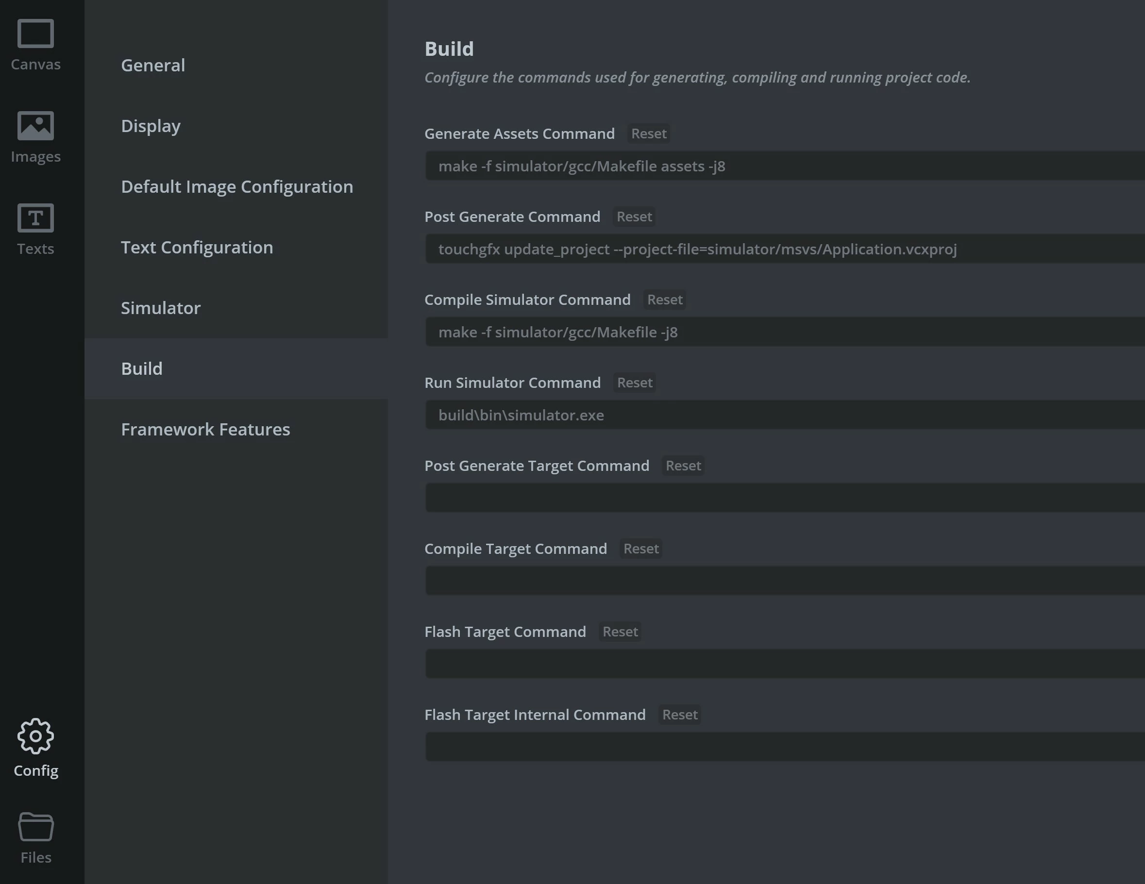

    Have you applied any changes to the Build commands in TouchGFX Config?
    I mean this section:
    Build CommandsBuild Commands
    Mohammad MORADIST Software Developer | TouchGFX

    Feb 9, 2024 1:36 PM UTC
    Hi Mohammad,
    Settings are same as your configuration. Screenshot is in the attachment.
