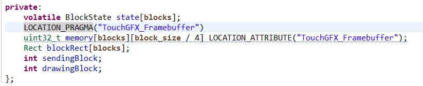

I'm setting up my LCD in SPI mode on my STM32F429 Discovery board. So the framebuffer is set as partial (ManyBlockAllocator).
So my question is whether I can define this framebuffer in the SDRAM to save up some space.
Thanks in advance

Hi Romain,
Thanks for the response.
I have already read the links that you sent, but the difference with partial framebuffers is that partial ones are not simply stored as a single variable. The function that constructs the buffer is defined in the FrameBufferAllocator.hpp file and I cannot find a way to use LOCATION_PRAGMA for instance to set the location that the buffers are stored.
I tried to put the LOCATION_PRAGMA there but I had no luck and encountered this error: "section attribute not allowed for 'memory' "0693W000007CZS2QAO.png

Hello @MMoha.3​ ,
FYI, Partial Framebuffer was created for low cost solution where you don't have external RAM. If the Partial Framebuffer fits perfectly in G0, I'm pretty confident it should fit in the internal RAM of an F429 (256 Kbytes for F429 against 36 Kbytes for G0).
I don't understand your use case, could you elaborate ?
