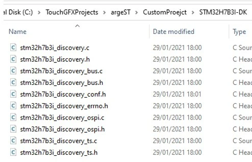

Then I copied STM32H7B3I-DK  folder from same directory and deleted unnecessary files.0693W000008wPYuQAM.jpgThese 9 files are needed.

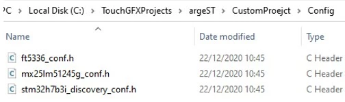

After that I created a folder to copy files from original project in Core/Inc.

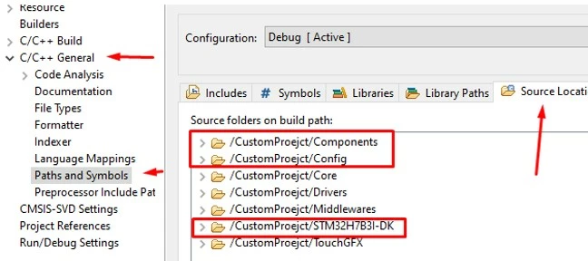

0693W000008wPc3QAE.jpgThen in the CubeIDE I add those folders as Source Location and Includes otherwise we cant have correct output files and my problem was this.

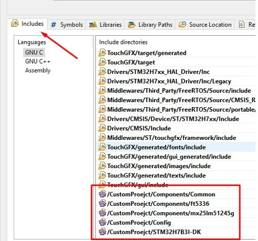

0693W000008wPd1QAE.jpgThen I added this files to Includes for both C and C++.
