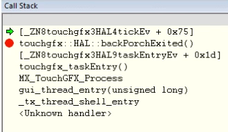

I have set up TouchGfx with CubeMx and TouchGfx Designer, then copied the necessary and generated files into an existing project based on ThreadX RTOS. The display driver is already tested and the initialization code is already transferred to the display (MX_TouchGFX_Init() finishes). But when calling the MX_TouchGFX_Process(), a hard fault appears:

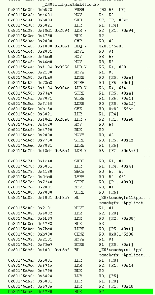

0693W000008wiOUQAY.pngBecause no source code is provided, I can’t figure out why it crashes:
0693W000008wiOyQAI.pnghow can I figure out, what has happend?
I’m wondering, if thre is any error handling within the TouchGfx Assembly code for such cases.

solved:
void TouchGFXHAL::initialize()
  // Please note, HAL::initialize() must be called to initialize the framework.
  TouchGFXGeneratedHAL::initialize();
