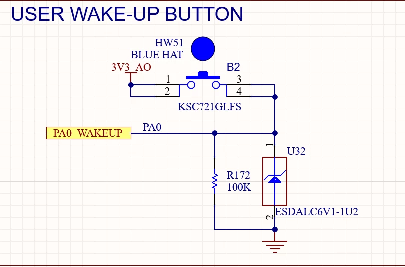

When I run this code, the Tamper button (Key = 0) works and the screen scrolls as intended. However, the Wakeup button (Key = 1) does not work. I click it and nothing happens. I have configured both the Tamper key and the Wakeup key in my GPIO initialization the same as the BSP for the STM32H7B3I-EVAL board buttons. In other words:
Tamper (Working)
 /*Configure GPIO pin : PC13 */
 GPIO_InitStruct.Pin = GPIO_PIN_13;
 GPIO_InitStruct.Mode = GPIO_MODE_INPUT;
 GPIO_InitStruct.Pull = GPIO_PULLUP;
 HAL_GPIO_Init(GPIOC, &GPIO_InitStruct);
Wakeup (Not Working)
 /*Configure GPIO pin : PA0 */
 GPIO_InitStruct.Pin = GPIO_PIN_0;
 HAL_GPIO_Init(GPIOA, &GPIO_InitStruct);
I ran the debugger on my code and confirm that is enters the first if command in my sample() polling function, but not in the second if, which is my wakeup button.
Can anyone help me figure out why?

MM..1
December 22, 2022
Check schematics if Wakeup button have own pull down/up. Change code SET/RESET ...
KMew
KMewAuthor
Senior III
December 22, 2022
Hello MM,
The BSP uses no-pull, but this is the schematic of the Wake-up button. I attempted both no-pull and pulldown though, and the result is the same.
Also, when you say change code SET/RESET, do you mean in my sample() function?
MM..1
December 22, 2022
Check with multimeter if button 3V3 exist on PA0
