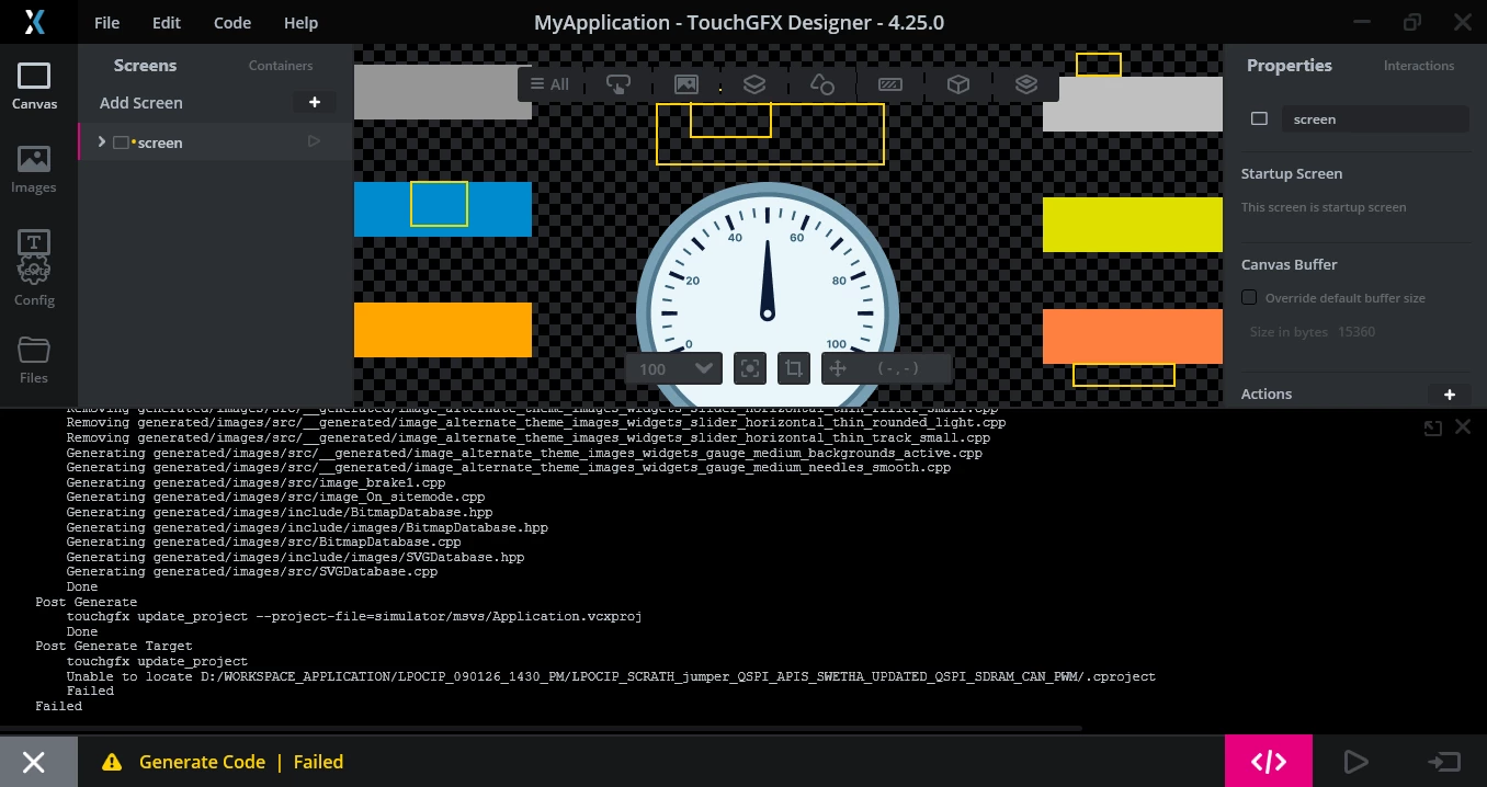

I have written application code for Core-M7, and when I try to generate images / assets using TouchGFX, the generation fails during Post Generate Target.
Error observed:
Post Generate
touchgfx update_project --project-file=simulator/msvs/Application.vcxproj
Done
Unable to locate D:/WORKSPACE_APPLICATION/LPOCIP_090126_1430_PM/LPOCIP_SCRATH_jumper_QSPI_APIS_SWETHA_UPDATED_QSPI_SDRAM_CAN_PWM/.cproject
Failed
Failed
However, the actual .ioc file exists at:
D:/WORKSPACE_APPLICATION/LPOCIP_090126_1430_PM/LPOCIP_SCRATH_jumper_QSPI_APIS_SWETHA_UPDATED_QSPI_SDRAM_CAN_PWM/CM7/.cproject

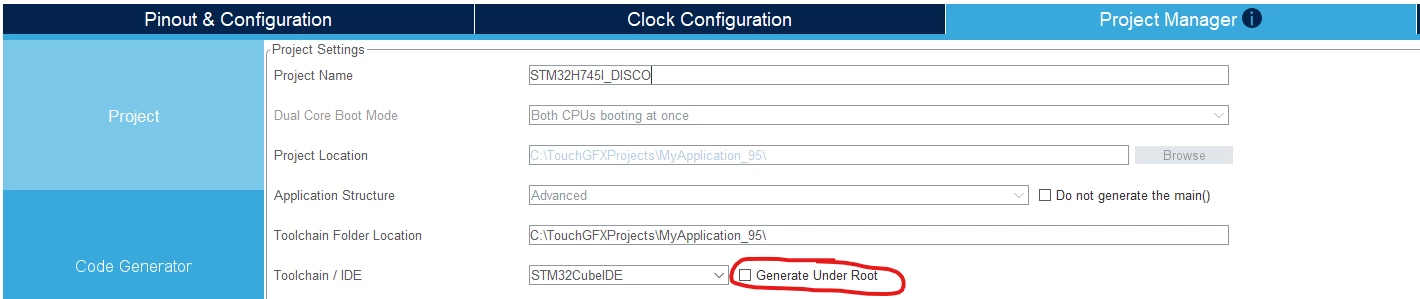

From your description it sounds like TouchGFX thinks the "Generate under root" option is enabled. Could you please verify in STM32CubeMX that it is not enabled?
If you haven't seen it already, you can have a look at the STM32H745I-Disco TBS available in TouchGFX Designer for reference.
Best regards,
Johan

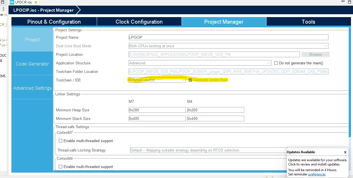

Jan 29, 2026 4:17 AM UTC
Hello @JohanAstrup
I apologize for the late reply. I was busy with some work.
I have verified the option, and it is ticked. Please have a look.
Regards,
Pankaj.
JohanAstrupBest answer
Feb 2, 2026 10:51 AM UTC
No need to apologize - I have been very busy myself :)
Using the "Generate under root" option is not the recommended project structure when using TouchGFX, as also mentioned here in the documentation.
Is it a requirement in your project to use Generate under root?
If so, there may be a workaround; however, I have not verified that it works for dual-core projects, and there is a risk of encountering additional issues:
You can manually specify the location of the project file in the TouchGFX part file. By default, the .ioc file is referenced to always update the project for the selected toolchain. You can try to manually reference the STM32CubeIDE project file instead.
