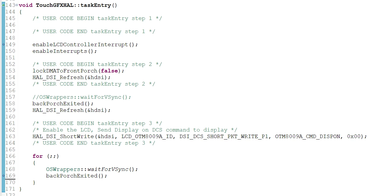

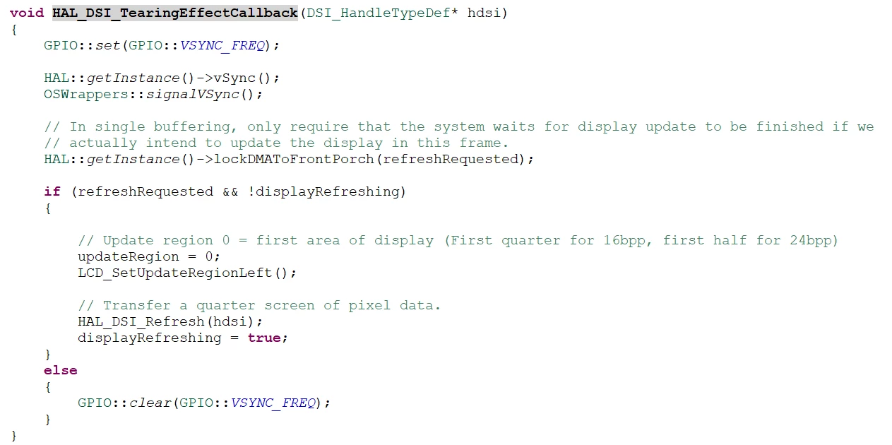

Now when TouchGFX starts, taskEntry sits at OSWrappers::waitForVSync(); I assume that this VSync should be called from HAL_DSI_TearingEffectCallback in TouchGFXHAL, but this callback never fires. It appears a tearing effect is requested earlier in taskEntry by LCD_ReqTear, which in the discovery code writes OTM8009A_CMD_TEEON to the LCD driver. I have modified LCD_ReqTear to send OTM8009A_CMD_WRTESCN with a param of 533 (0x2,0x15) instead, as per the CMDMode_TearingEffect example, but the TearingEffectCallback is still not triggered.
What am I missing here? I can't attach the full project for confidentiality reasons, but I'm happy to share main.c and TouchGFXHAL.cpp
I'm aware also that TearingEffectCallback and EndOfRefreshCallback still contain code that assumes the display is split in two (as per both the examples I have borrowed from), I wouldn't have thought this was the issue however, as neither of these callbacks ever fire.
Edit
I have updated taskEntry to enable the DSI interrupts and call a DSI_Refresh before the first wait for Vsync, but the  callbacks still don't fire. Examining the SFRs shows that the DSI transfer hangs on BUSY (DSI_WISR), so presumably the callback doesn't fire due to the refresh never finishing. What could be preventing the transfer from occurring?

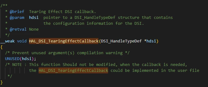

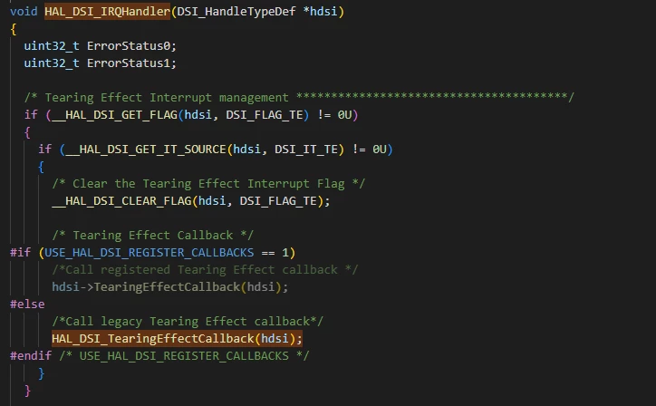

Nov 7, 2024 3:37 PM UTC

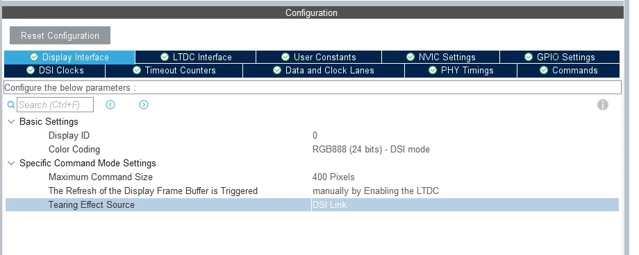

I'm not sure where this goes wrong, but I can try to explain what I would do in this case, maybe there is a missing step somewhere in that process.
First, since you should now be getting TE signals on the bus rather than on a GPIO, set that under DSIHOST in CubeMX:
Now,when your DSI interrupt fires, it should be able to determine if a TE signal has been received:DSIIRQHANDLER.png
HAL_DSI_TearingEffectCallback() is weak, so you can define that yourself, which it seems from what you write is already done in TouchGFXHAL.
Are you still running adapted command mode, or are you in video mode?
Have you looked at the code that split the display in two? I get that that can be a very confusing solution, but what basically happens is that the LTDC frame buffer pointer is moved, and then an LTDC transfer to the screen is triggered. If a transfer is never triggered, I'm not sure there would be a callback, but I'm not sure wether you actually ever get to that point?

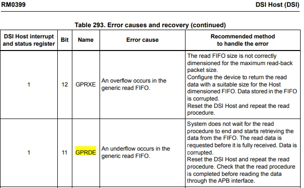

Interestingly, as soon as I call DSI_Start, the GPRDE bit is set in the DSI ISR1 register. Could this be an indicator for something? I also get constant LTDC interrupts with no flags in the LTDC ISR, so I assume this is cause by GPRDE.
Nov 8, 2024 1:18 PM UTC
The reference manual for H747 has this detail about the GPRDE bit:
In the original TouchGFX project, the LTDC is turned off when the DSI_Start command is called. It may lead to some undefined behaviour if the DSI is in the middle of a transfer when the DSI host starts up, so I would try to call
__HAL_LTDC_DISABLE(&hltdc) before starting DSI and __HAL_LTDC_ENABLE(&hltdc) after.
You might also have noticed that there is a 1 ms delay in the original HAL_DSI_EndOfRefreshCallback. I do not actually know why it is there, but I do know that the whole thing stops working if it is removed. My guess is that it ensures that the DSI bus or LTDC is ready for the modification that will happen because of the half-screen thing, so you could also just try to add a delay before starting the DSI host.

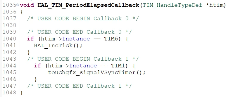

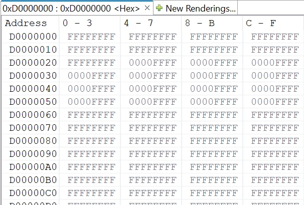

Iris-DMAuthor
Nov 14, 2024 11:14 AM UTC
I've made progress, but still no complete working solution. I'm now using a timer to trigger vsync every 20ms from main:
When my code launches, the first framebuffer is written to the LCD. This is done by forcing a DSI Refresh from TouchGFXHAL::taskEntry(). The refresh that writes to the screen is on line 154.
This is fine, so long as my display is static. We get through backPorchExited() and go into the infinite loop, checking for vsync - although nothing ever actually changes in the framebuffer as there's nothing new to display.

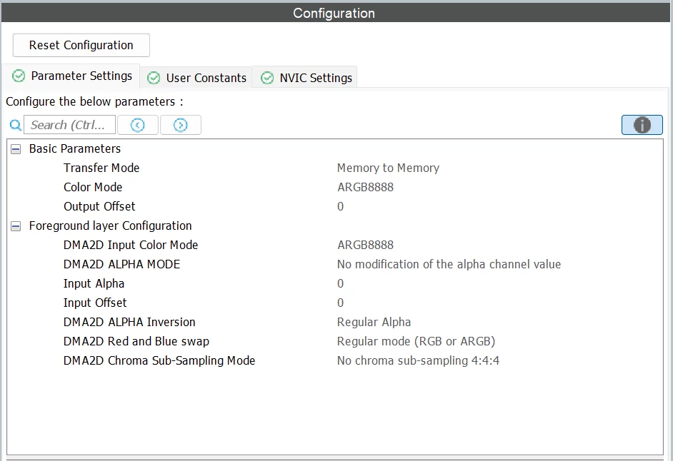

If the framebuffer needs to be updated, either through user code in the view or putting an animated image in the display, the first refresh draws the initial framebuffer, but backPorchExited() never returns, it gets stuck on Model::Tick().
I have to assume that there is an issue with the updating of the framebuffer. Its address is allocated in CubeMX - does this need manually setting in TouchGFXHAL::initialize()?
And DMA2D is configured with a matching format
We're using external SRAM here, but FMC is configured and correctly as I can see the framebuffer in the memory monitor
What other issues could cause the hang when copying the new framebuffer?

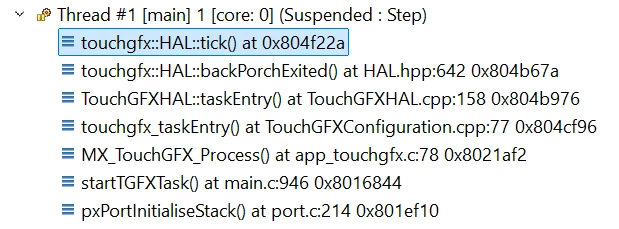

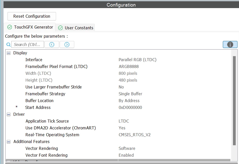

Nov 14, 2024 12:22 PM UTC
One thing that could lead to the tick method hanging is trying to measure MCU usage but not having the correct hooks in the OS to support this.
Do you have a call to enableMCULoadCalculation(true) somewhere? I believe removing that (or setting it to false in TouchGFXHAL::initialize()) would solve the problem so TouchGFX can execute.
I would advise using double buffers if you have space for that in RAM. In general, it is easier to have their address set by allocation than by manual address.
If set to by allocation, you can define what sector they go in with the linker script, you can see how that is handled for your particular compiler in most of the board setups that ship with the TouchGFX designer.
As you set it by address, it will be placed at that address.
You can see what the start address of the currently active framebuffer is in the LTDC->CFBAR register.
But with single frame buffer and no TE signal to synchronize, I would expect tearing on the display when anything moves.
Iris-DMAuthor
Nov 14, 2024 12:30 PM UTC
I did have enableMCULoadCalculation(true) set, but I have now removed it, along with mcuInstr.init() and setMCUInstrumentation(&mcuInstr). Unfortunately, this doesn't change anything.

This is the stack from the point that the task locks up
Without access to the HAL source, I can't probe this any further
