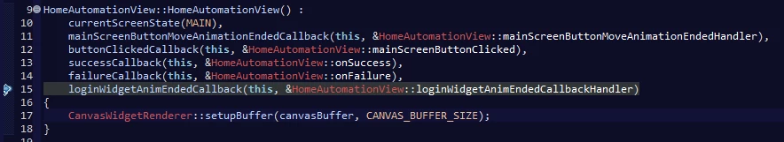

Then start programming on custom board, it works fine. But it is weird that the Home Control is always getting stuck. And I try the TouchGFX simulator it is work.
What I`m doing the next step, is to get in to debug mode and check the process. And I found it always stuck at "syscalls.c" with no reason.
Is there any suggestion or experience about syscalls problem?

Here is the problem, when I trying to start  the Home Control demo, it will stock at the main page and cannot work or touchable, then I debug the code at the stock screen, it stops at the syscalls.c as previous topic.

Are you sure you have dedicated enough space to the heap and the stack?
There shouldn't be a problem with the code of the application, and STM32H7 series are capable MCUs, so I suggest checking the configuration of your custom board. There is a good chance that the problem comes from the heap or stack size (For instance set them to 0x1000).
