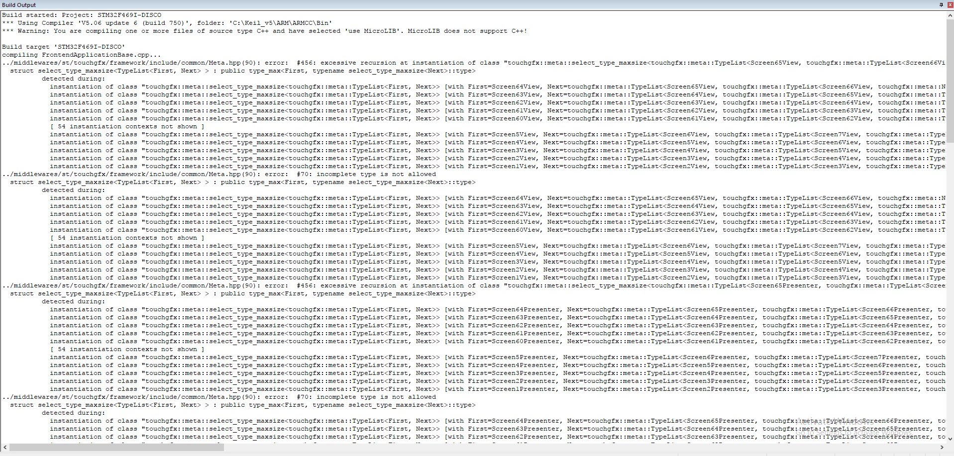

Keil projects shows an error when I add more than 65 screens in the project (works fine with less than or equal to 65 screens). I checked this multiple times by creating multiple new projects and even multiple versions of cubemx and touchgfx designers still no luck. I have tried cubemx 5.3, cubemx 5.6, cube mx 6.0 basically every version since 5.3. I even tried diffrent touchgfx designers from 4.10 to 4.15. When I create the same project with more than 65 screens for STM32cubeIDE it works perfectly fine.
Here's the procedure I follow
  1. Open touchGFX designer
  2. Select my board STM32F469i-DISCO and Blank ui
  3. Add 66 screen and 2-3 buttons
  4. Generate project
  5. Open cubemx file of project and select MDK ARM 5.28.0.0 Keil IDE and generate project for keil
  6. Open project in keil
  7. Compile errors in meta.h file which is part of touchgfx framework and not a user file
If if follow above steps for less than or equal to 65 screens It works fine. And everything works for STM32CubeIDE even 66+ screens
You can easily reproduce this error by following above steps

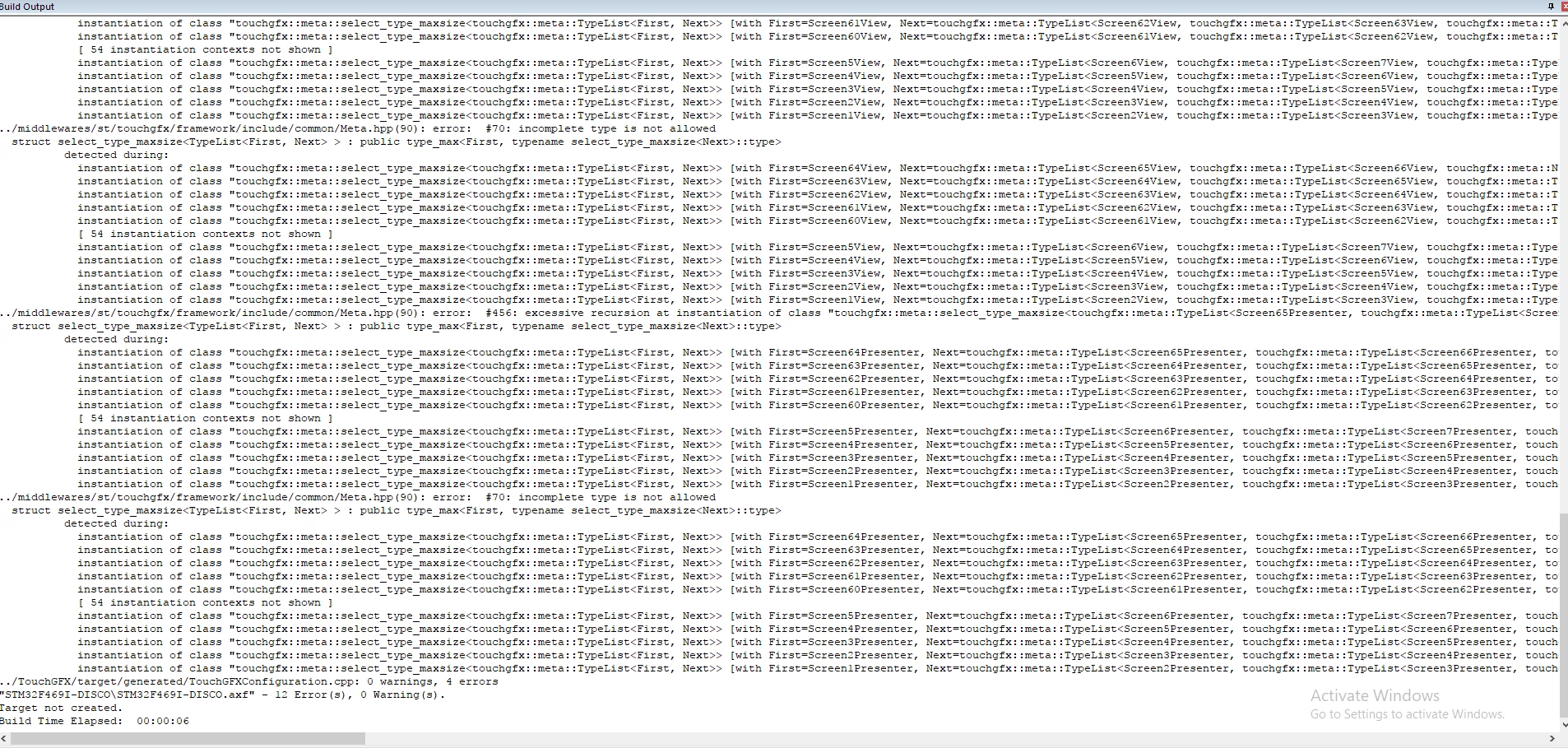

../middlewares/st/touchgfx/framework/include/common/Meta.hpp(90): error: #456: excessive recursion at instantiation of class "touchgfx::meta::select_type_maxsize<touchgfx::meta::TypeList<Screen65View, touchgfx::meta::TypeList<Screen66View, touchgfx::meta::Nil>>>"
 struct select_type_maxsize<TypeList<First, Next> > : public type_max<First, typename select_type_maxsize<Next>::type>
     detected during:
      instantiation of class "touchgfx::meta::select_type_maxsize<touchgfx::meta::TypeList<First, Next>> [with First=Screen64View, Next=touchgfx::meta::TypeList<Screen65View, touchgfx::meta::TypeList<Screen66View, touchgfx::meta::Nil>>]" at line 90
../middlewares/st/touchgfx/framework/include/common/Meta.hpp(90): error: #70: incomplete type is not allowed
     detected during:
../TouchGFX/target/generated/TouchGFXConfiguration.cpp: 0 warnings, 4 errors
"STM32F469I-DISCO\STM32F469I-DISCO.axf" - 12 Error(s), 0 Warning(s).
