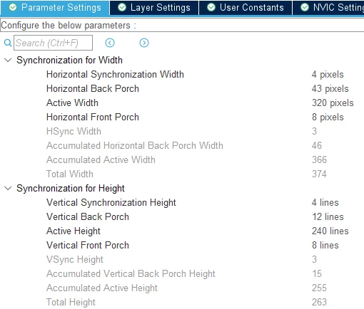

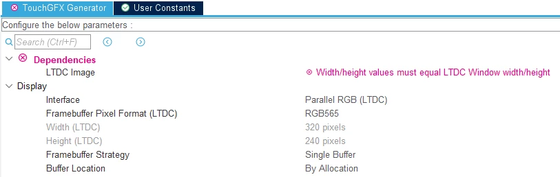

TouchGFX / LTDC "Width/height values must equal LTDC Window width/height"
Project = CubeMX + STM32F469ZITx + 320x240 TFT.
I have set up CubeMX correctly as far as I can tell, but I am getting the error "Width/height values must equal LTDC Window width/height"
In the TouchGFX Generator, they are populated automatically!, so how can they be wrong?
Please advise where I have made a mistake.
Thanks,
Chris.

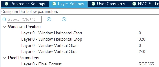

Hello @CCowd.1​ and welcome to STCommunity :) ,
Please check if the Frame Buffer line length and the Frame Buffer Number as well configured in Layer Settings as shown in the below figure.
Also, I recommend you to take a look at his MOOC..

CCowd.1
CCowd.1Author
Apr 3, 2023 2:53 PM UTC
Perfect - many thanks. That fixed it. Now onto the next snag... :face_without_mouth:
