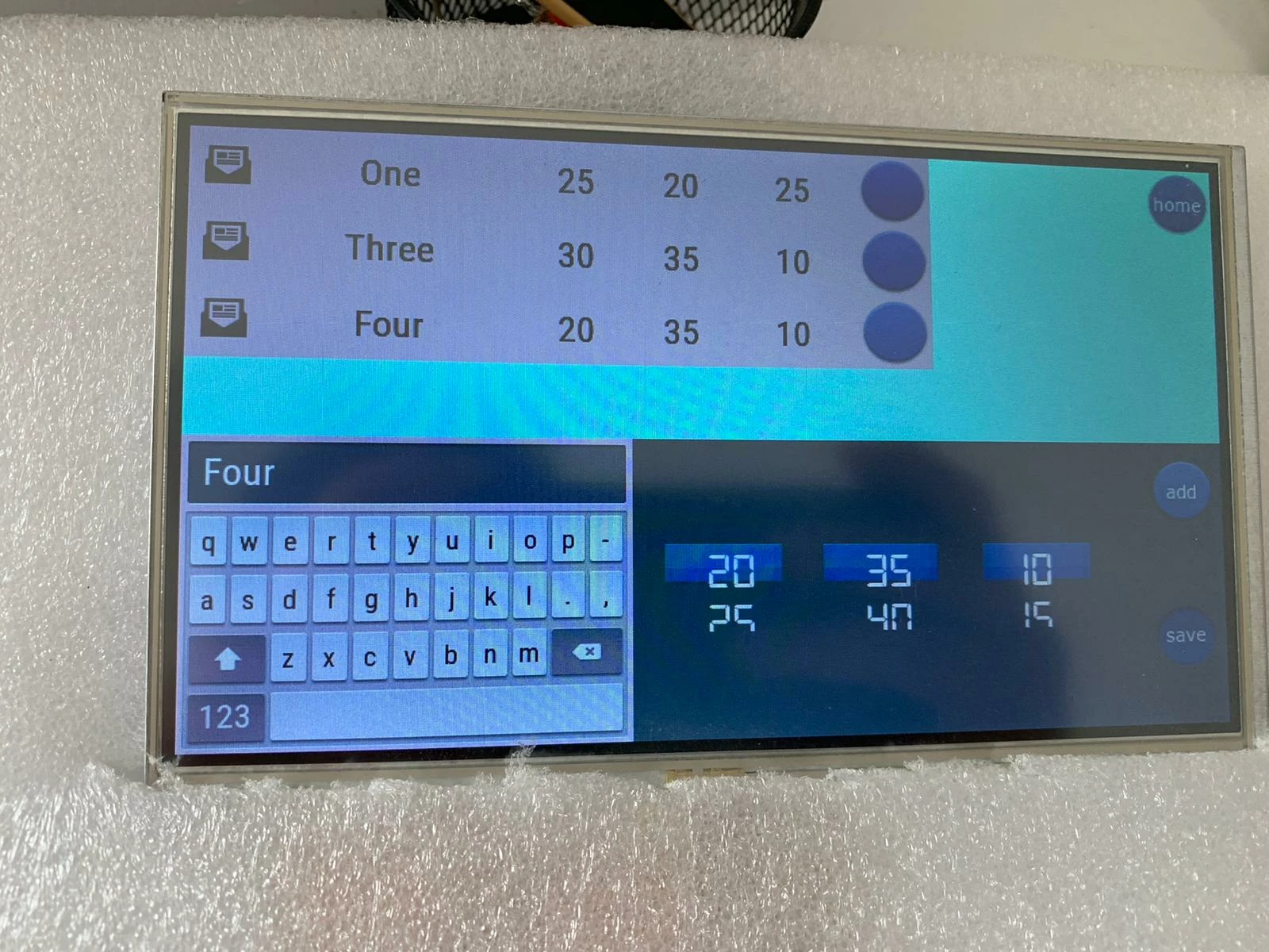

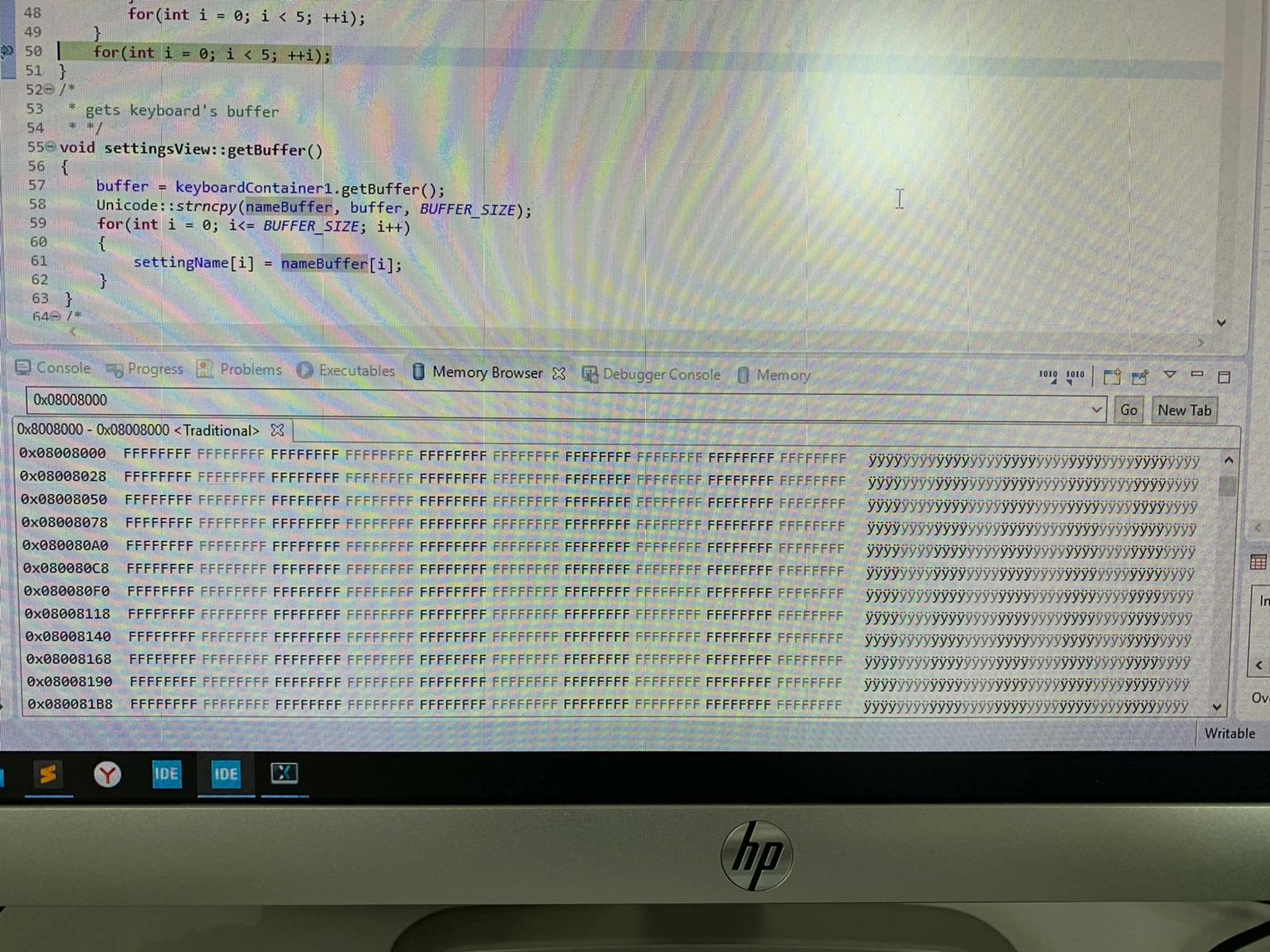

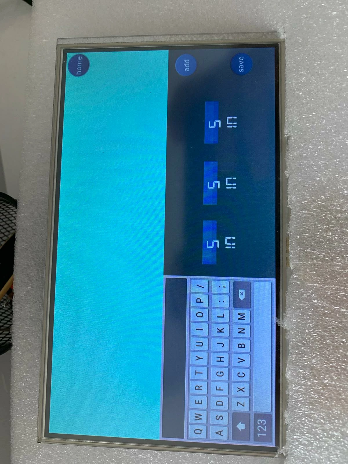

I'm using list layout for my UI application. I'm holding some settings on the list and saving that data into flash. But when I erase an element(for example element 3 out of 6). element 3 erasing on the screen but not from the buffer. So when I write the data to flash I element 3 is still there but 6 is gone.
In here I don't have any elements and data on flash0693W000001skLgQAI.jpg0693W000001skLCQAY.jpg

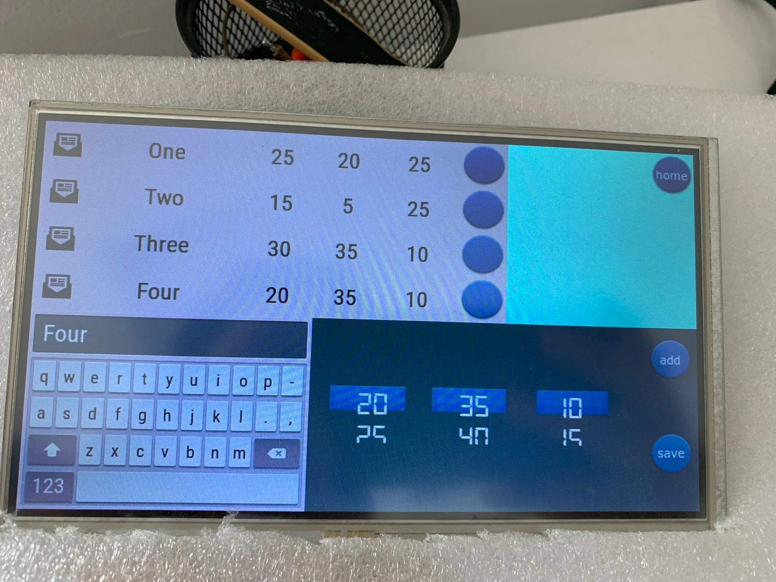

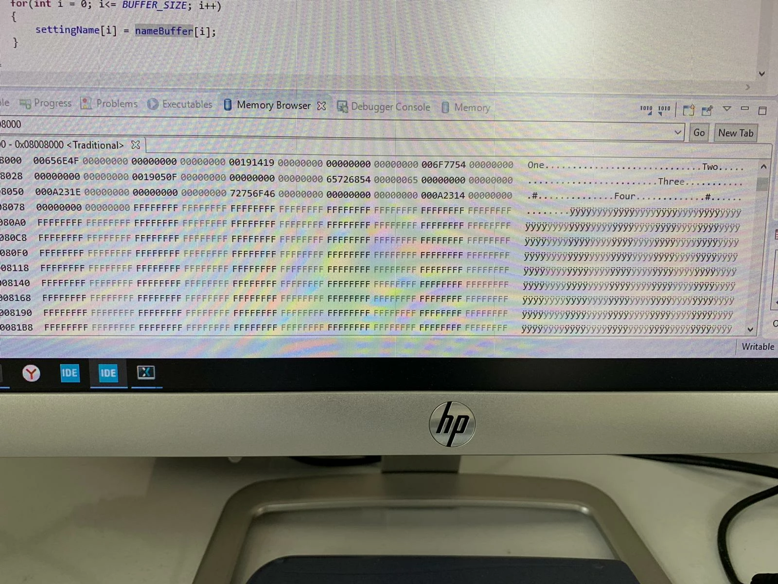

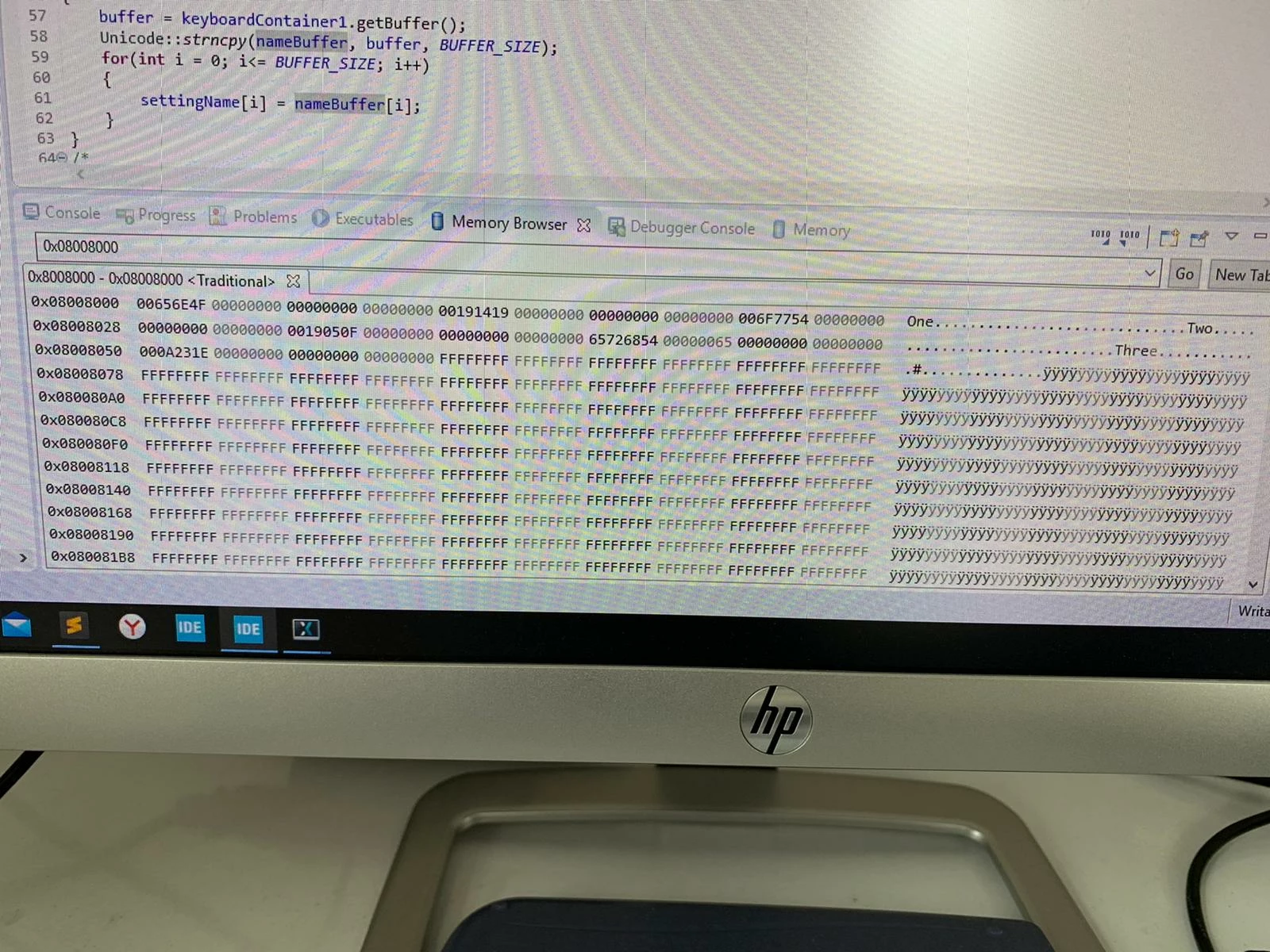

Here I wrote data on flash
And here I erased second element (name two) and it didn't erase but number four is gone.
I'm using list example's code for erasing.

  • On your post you write "And here I erased second element (name two) and it didn't erase but number four is gone." but on the pictures you attached, it's number 2 that is removed from the GUI like it should. Number Four is still displayed on your picture.

Yes it did removed from the screen but it is still in the memory. After I erased listElements[1] (named two) and write the whole list to the flash, it appears I couldn't erase listElements[1] insted I erased listElements[3](named four).
By buffer I mean from the memory alocation for list elements.
And it appears when I write it to flash (When I executed void settingsView::saveButtonHandler()) and all this function does is reading list elements and write them to the flash.

I checked it again it seems number four doesn't erase too. I don't write it to the flash because I decrease the listIndex whenever I erase element so I exit from the loop before number four is written. So my new problem is when I erase element it isn't exactly erasing It just doesn't seem on the screen. Can I actually erase or destroy one of the list elements? Not just from the screen but from the RAM as well.

I think I found why it does not work and it's a coding mistake.
Here you can see the two functions (the one that saves in the Flash and one that is supposed to delete the element):
	HAL_FLASH_Unlock();
	FLASH_Erase_Sector(FLASH_SECTOR_1, VOLTAGE_RANGE_3);
	HAL_FLASH_Lock();
	listIndexSaved = listIndex;
	int valf1, valf2, valf3;
	for(int i = 0; i < listIndex; ++i)
		nameBufferptr = listElements[i].getBuffer();
		valf1 = listElements[i].getValueBuffer(1);
		valf2 = listElements[i].getValueBuffer(2);
		valf3 = listElements[i].getValueBuffer(3);
		Unicode::strncpy(nameBuffer, nameBufferptr, BUFFER_SIZE);
 // Some other code ....
 * removes element from the list
void settingsView::listElementClicked(listElement& element)
	list.remove(element);
	--listIndex;
	if(listIndex <= 0)
		listIndex = 0;
	scrollCnt.invalidate();
I you look closely, you remove item from list but you take the string from listElements. And from what I understood so far you don't delete the correspond element in listElements.
