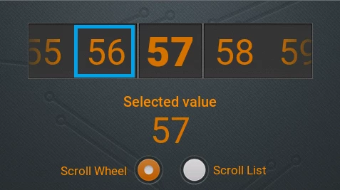

I am able to send Text information from PC UART to TouchGFX Text Area (with WildCard).
How do I show List of File names from USB Thumb Drive with
<Fwd> <Rev> for Scrolling Images if all file names are not fit on screen .
<select> Selected File Name should be Highlighted .
<remove> for remove/Delete from List
with TouchGFX  ?
Which Widget should I use ..
Is there any demo in TouchGFX ?
Please Advice ..
Karan

Scroll Wheel - It has a "selected item" in the center. Read the doc about it at support.touchgfx.com.

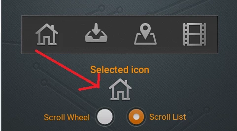

April 22, 2020
@Martin KJELDSEN (ST Employee)
Thanks for link . I have read and run demo "Scroll Wheel and Scroll List " as below:
1) Is it possible to "Highlight " Selected any item on click ,rather than center ?
2) Can I use <Fwd> <Rev> Button for Scrolling ?
