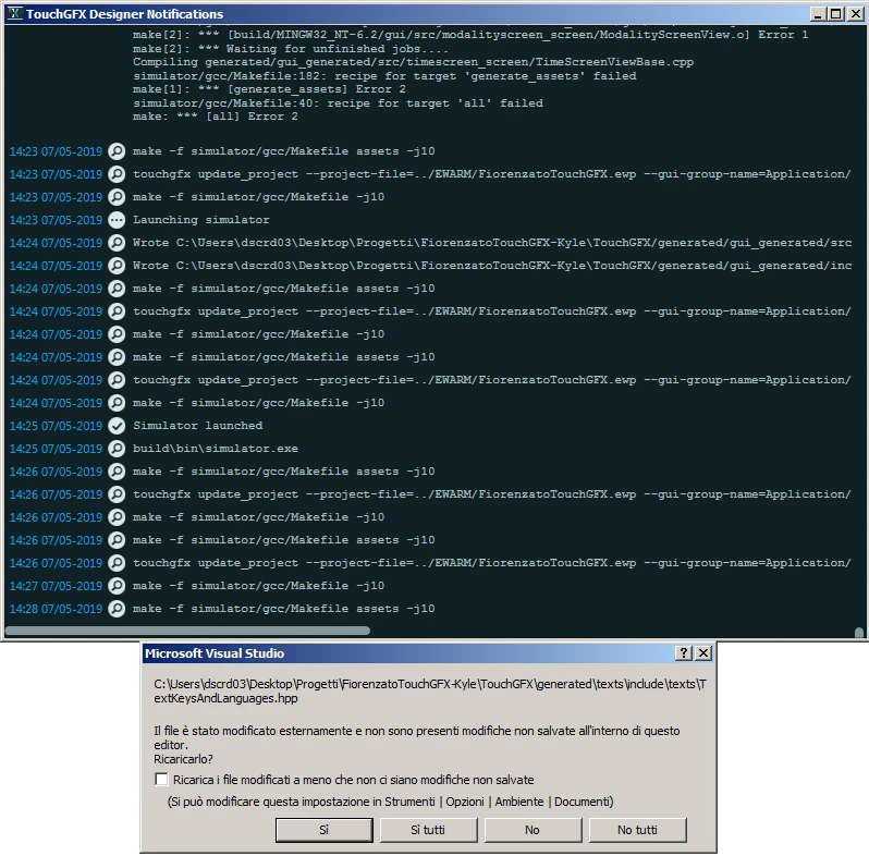

As title say, today my TOUCHGFX keep compling again and again even with no chenge in the code or the layout ( i literally took away my hands from keyboard, but he keeps compiling as u can see in the picture above)
I apology for the second part of the image being in Italian, but essentially it's visua studio saying that some file has been changed by someone(touchGFX i'd say) and needs to be reloaded, and this keep happening, when hefinish to compile... he compiles again, my pc is melting. Any clue/help/fix?

Which version of TouchGFX are you using? We've modified the way the designer determines how to generate code and compile. By default the designer now does nothing at all, so it's up to the user to generate code and/or compile when he or she wants to.

I'm using TouchGFX Designer 4.10.0
