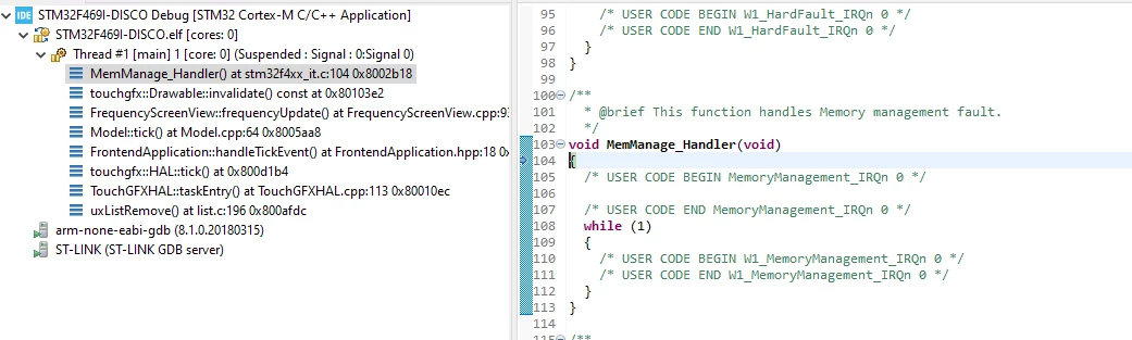

TouchGFX - invalidating a textAreaWithOneWildacard causes Memory Management Interrupt.
Hi. I am trying to make a tester for a PCB and implemented ADC value display and Timer PWM output with no issues thanks to examples and youtube videos.
Application has 2 screens, 1 with ADC measurements and 1 with Frequency Check. When trying to update textAreaWithOneWildcard on the 1st screen there are no issues, but doing same on 2nd screen causes system to fall into Memory Management Interrupt Handler (both screens use the similar logic, names of variables and methods are different).
The debugger can not provide any Error details as the issue seems to be in the Drawable class.
The definition of all textAreasWithOneWildcard is similar (position, buffer lengths are different obviously).

// 2nd screen display function - crashes to Memory Management Interrupt handler
void FrequencyScreenView::frequencyUpdate(uint32_t frequency1, uint32_t frequency2, uint32_t frequency3)
	memset(&frequencyValue_****, 0, FREQUENCYVALUE_****_SIZE);											// fills array with 0s
	Unicode::snprintfFloat(frequencyValue_toONBuffer, sizeof(frequencyValue_toONBuffer), "%.2f", frequency2 * 0.001); // displaying converted value of Low to High frequency in kHz
	frequencyValue_****.invalidate();
	memset(&frequencyValue_toOFF, 0, FREQUENCYVALUE_TOOFF_SIZE);
	Unicode::snprintfFloat(frequencyValue_toOFFBuffer, sizeof(frequencyValue_toOFFBuffer), "%.2f", frequency3 * 0.001); // displaying converted value of High to Low frequency in kHz
	frequencyValue_toOFF.invalidate();
	memset(&frequencyValue_Current, 0, FREQUENCYVALUE_CURRENT_SIZE);
	Unicode::snprintfFloat(frequencyValue_CurrentBuffer, sizeof(frequencyValue_CurrentBuffer), "%.2f", frequency1 * 0.001); // displaying converted value of Current frequency in kHz
	frequencyValue_Current.invalidate();
_legacyfs_online_stmicro_images_0693W000006GhKP.pngAttached is my CubeIDE application project, just need to add "Middlewares" folders in CubeIDE.

WTF is memset(&frequencyValue_****, 0, FREQUENCYVALUE_****_SIZE);
and all memset in freq miss Buffer in names.

'*' filled in space of the word that the Comment editor sees as offensive - to ON as one word comes as **** that is not allowed here.
memset is to overwrite previous characters in the array, just in case new value doesn't fill the whole array
