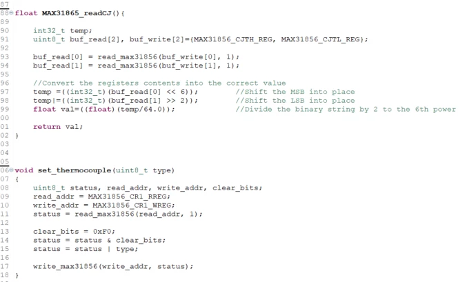

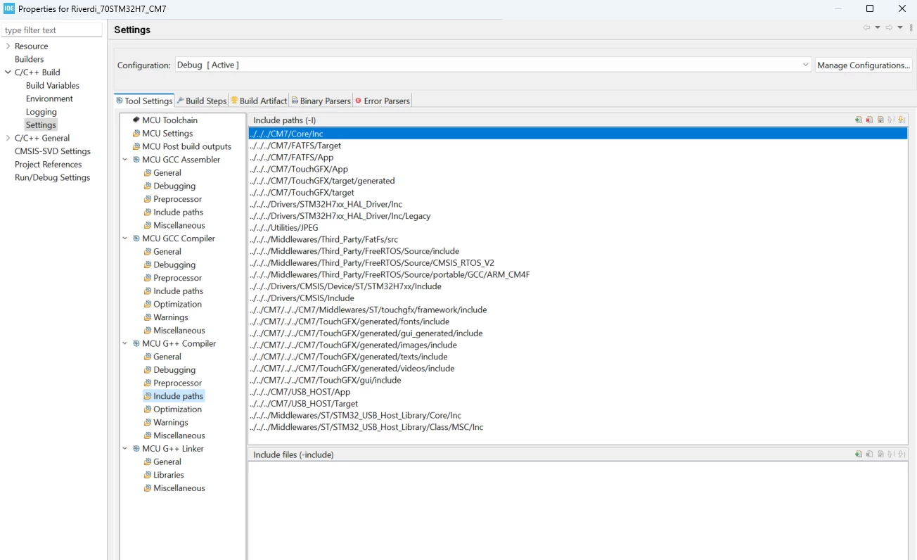

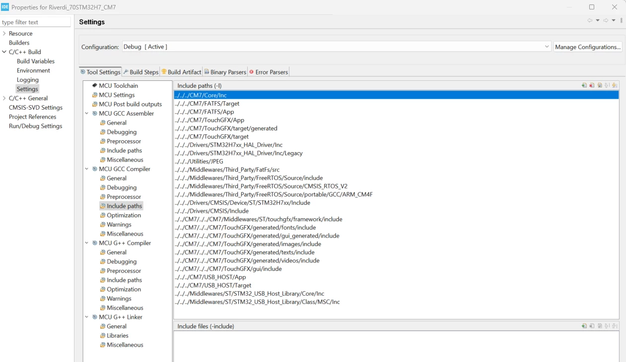

Next, I added the files pertaining to the MAX31856 temperature sensor that I'm using and please note that these files are in C and not C++. I also made sure that they were included in the project correctly however I'm not certain. Below are the include paths, the sensor files and the sensor file position in the project explorer:
A) GCC Compiler -> Include paths:
B) G++ Compiler -> Include paths:

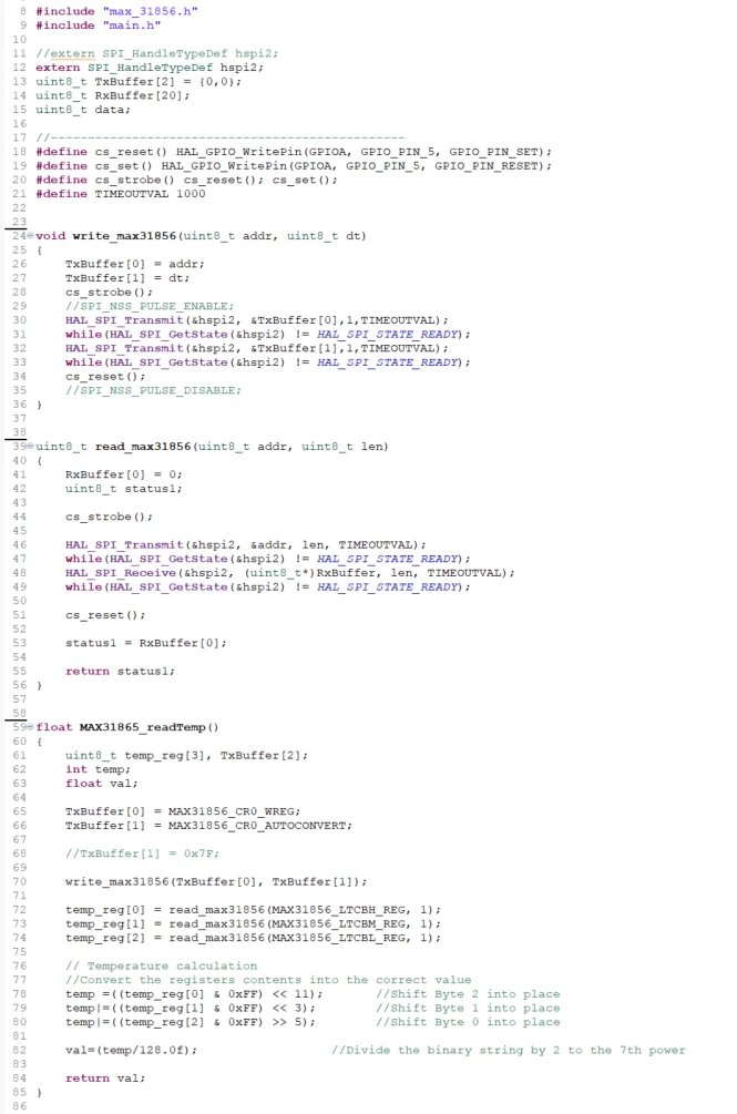

C) MAX31856.c and .h files:
MAX31856.c file:

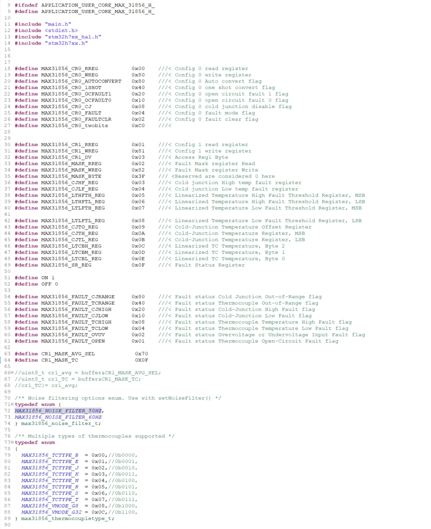

MAX31856.h file:

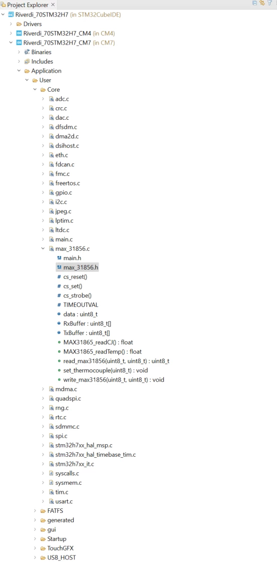

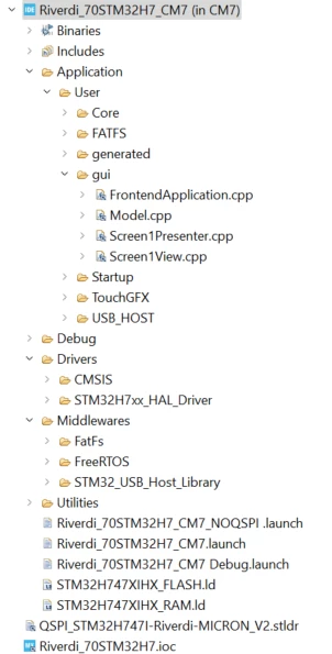

D) Project Explorer View:

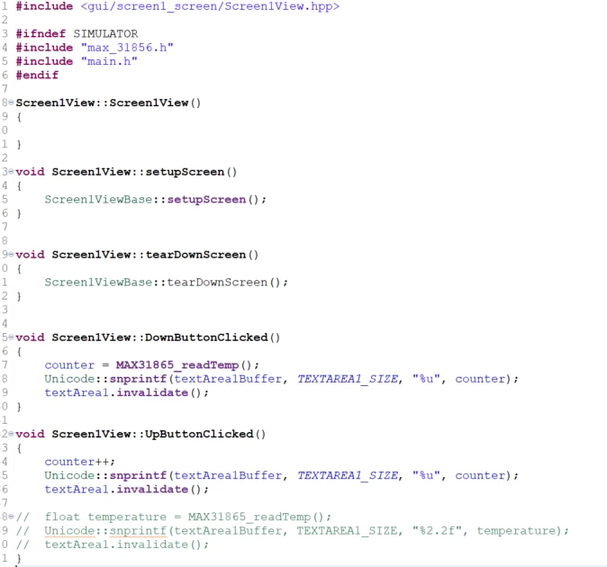

Below is the Screen1View.cpp file that was generated by the Designer and I've tried to call one of the functions into it but it gives me an error message:
 Error message:
C:/Tempcounter/CM7/TouchGFX/gui/src/screen1_screen/Screen1View.cpp:27: undefined reference to `MAX31865_readTemp()'
collect2.exe: error: ld returned 1 exit status
It would be great if anyone could help with this issue!

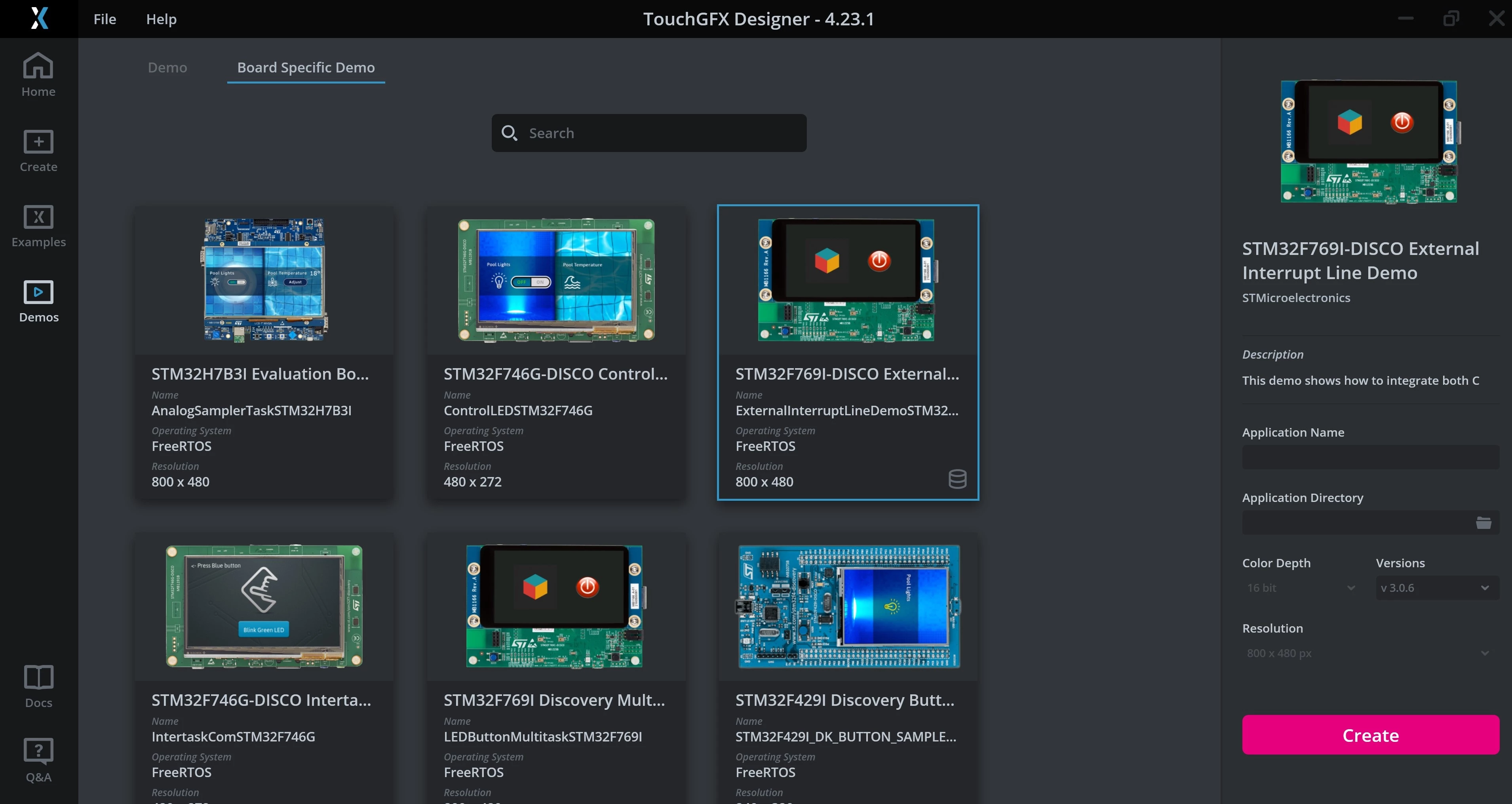

First of all, I got a bit confused by your statement "I was able to successfully build the Touch GFX project and was able to access the 'gui' folder generated by the designer", are you trying to create a custom project yourself? Or are you using the available board setup in TouchGFX Designer?
And for the error you mentioned, you need to define some functions in the Model that will interact with MAX31856, and then, you need to call those functions in you Screen1View.cpp.
You can check the available Board Specific Demos to get inspiration for your project because they show how you can interact with the rest of the board.
Board Specific DemosBoard Specific Demos
I hope this helps you, don't hesitate to ask more questions.

Hello
You probably should use extern "C" in max_31856.h- file funtion definitions when calling from cpp- file.
Check this:
https://community.st.com/t5/stm32-mcus-touchgfx-and-gui/stm32h7b3l-eval-custom-screen-with-gt911-tc-interface-not-able/td-p/641237
Br JTP
Feb 27, 2024 11:11 AM UTC
Hi @JTP1 , I tried using extern as well but it didn't work, I'll use the MVP structure and try it, hope I'll have better luck.
