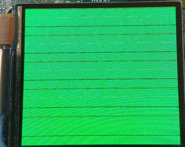

Hi All,
I need your help , I am configuring TouchGFX with DSI ( STM32F778AI ) with RM67162 360X320 pixels display.
Before adding TouchGFX I was able to write using LTDC,DMA2D and DSIHost without any pixel shift ( also without TE ).
After I added TouchGFX I suppose to have pixel shift , Basically what I done I tried to draw Red color on full screen and I have lines from top to bottom ( attached picture ).
TE is 60HZ coming from display.
Buffer configured to external memory to address 0xC0000000
I tried :
  1. LTDC clock slower to 10 MHZ - still the same.
  2. DSI-Host clock slower to 16 MHZ - still the same.

 Any Help?
Thanks!!!
