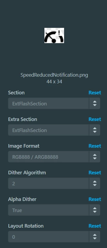

TouchGFX seems to mangle all of my .png images. The image is loaded directly into the flash and mapped in BitmapDatabase.cpp. Nothing special going on. Has anyone encountered this or have any troubleshooting ideas?
TouchGFX Designer Screen Capture:
0693W000007Aq1YQAS.pngTouchGFX Designer Screen Capture:0693W000007Aq1nQAC.pngTarget Picture:0693W000007Aq1xQAC.jpg

Looks like the correct answer was to set the image rotation to 90 deg. Thanks @MM..1​. I must have missed why this when setting up my Default Image Configuration: https://support.touchgfx.com/docs/development/ui-development/designer-user-guide/config-view#default-image-configuration
Is there any reason why this setting does not automatically attach to Display Orientation in Config -> Display?

MM..1
Jan 12, 2021 5:58 AM UTC
No @Alexandre RENOUX​ i report this bug here, when you set image angle 90 first build generate fail image, Changing angle twice correct this.
as here png-data does not show properly on the TouchGFX "Run Simulator" (st.com)
Or @ you set bad rotation 0 and need 90

I'm glad you find a way. FYI, since 180 degree screen rotation is done manually, this becomes heavy on the MCU because the entire framebuffer needs to be invalidated all the time. You will not be able to have high level UIs by doing so.
Display Orientation in Config -> Display and Layout Rotation in Config -> Default Image Configuration are linked to each other. It's strange it's not the case for you.
I tried with TouchGFX 4.15 and a project on F746-Disco and whenever I change the display orientation, the layout orientation is automatically modified. Maybe I misunderstood what you were talking about.

The purpose of having the 4 frame buffers is to simplify the rotating so that the framework does not have to completely redraw the assets every time. The framework thinks there is just a normal double framebuffer setup and then the completed frame is manually copied and inverted. It still slows down the app, but what would be rendering effort is instead memcpy operations.
