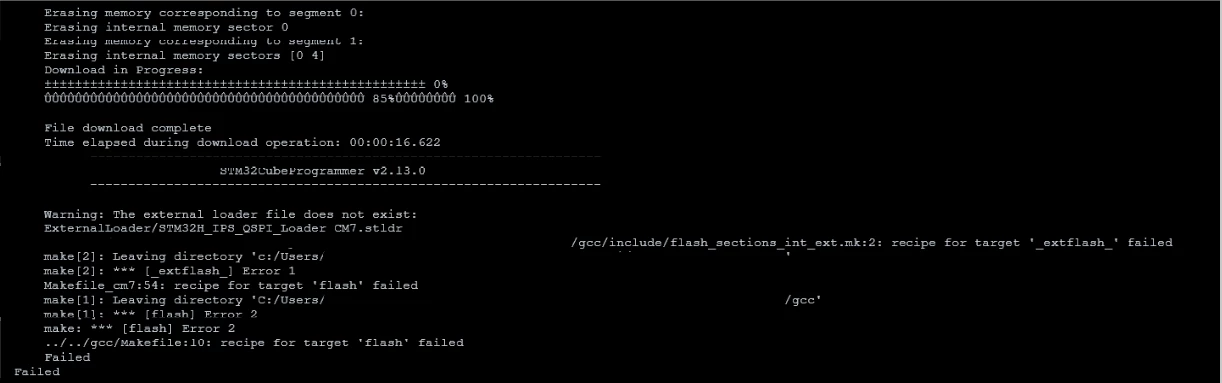

TouchGFX having issues flashing image assets to external flash

Hi, I was using this board: https://riverdi.com/product/7-inch-lcd-display-capacitive-touch-panel-air-bonding-uxtouch-stm32h7-rvt70hssnwc00/
The issue was resolved, I was missing the correct loader file for this board.

Hello @dbershad ,
Could you please specify which board you are using? And have you changed the placement of images through TocuhGFX Designer or by using linker scripts?
