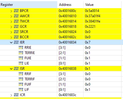

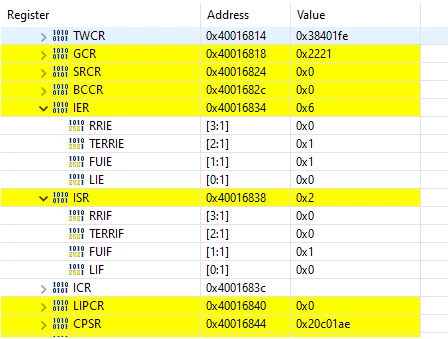

I did found that I wasn't enabling LTDC and DMA interrupts during HAL_LTDC_MspInit and HAL_DMA2D_MspInit. I enabled them but I keep having the same problem of running on a Infinite Loop.
I notice now that my program is going to default handler after GPIO::init() under GRAPHICS_HW_Init. Checking the ISR of LTDC I noticed that I'm having FIFO underrun Interrupt flag.
I found this article: https://touchgfx.zendesk.com/hc/en-us/articles/205676691-Debugging-Pixel-Error-Issues that refers to a similar error. I've tried to reduce the LTDC clock by a factor of 4 and my code progress a little and stops again on a infinite loop but now the ISR indicates an Line Interrupt Flag.
Any ideas on how to progress from here?
Thank you

Debugging the code, I found that the generated HAL_LTDC_LineEvenCallback was never called by LTDC Interrupt.
extern "C" void HAL_LTDC_LineEvenCallback(LTDC_HandleTypeDef *hltdc)
 if (LTDC->LIPCR == lcd_int_active_line)
 //entering active area
 HAL_LTDC_ProgramLineEvent(hltdc, lcd_int_porch_line);
 HAL::getInstance()->vSync();
 OSWrappers::signalVSync();
 // Swap frame buffers immediately instead of waiting for the task to be scheduled in.
 // Note: task will also swap when it wakes up, but that operation is guarded and will not have
 // any effect if already swapped.
 HAL::getInstance()->swapFrameBuffers();
 GPIO::set(GPIO::VSYNC_FREQ);
 else
 //exiting active area
 HAL_LTDC_ProgramLineEvent(hltdc, lcd_int_active_line);
 GPIO::clear(GPIO::VSYNC_FREQ);
 HAL::getInstance()->frontPorchEntered();
So add manually the following Handler:
extern "C" void LTDC_IRQHandler(void)
 if (LTDC->ISR & 1)
 LTDC->ICR = 1;
 HAL_LTDC_ProgramLineEvent(&hltdc, lcd_int_porch_line);
 else
 HAL_LTDC_ProgramLineEvent(&hltdc, lcd_int_active_line);
Now the when I start the debugging session I get to see the handler being called. But when I let the program run the it stops again in the Default_Handler:
