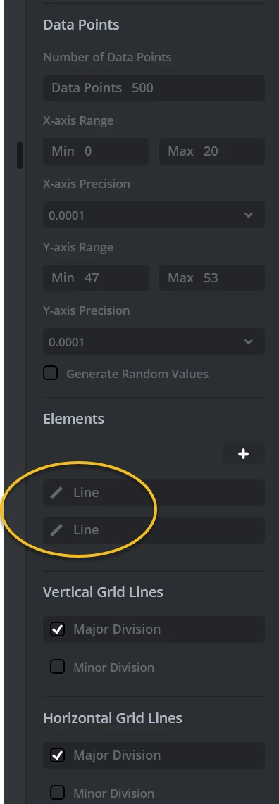

The TochGFX builder appears to provide for more than one variable to be plotted on a single graph:
But looking at the API for both types of graph there is no way I can see of specifying which line to use for the data.
I seems obvious that the data would have to have a common x and Y range as there is no provision for mult-range scaling.
If you cannot have more than one variable why does the designer provide for them?
In past projects I have overlaid multiple graphs to plot additional variables, but this is extremely tedious to build and maintain.
