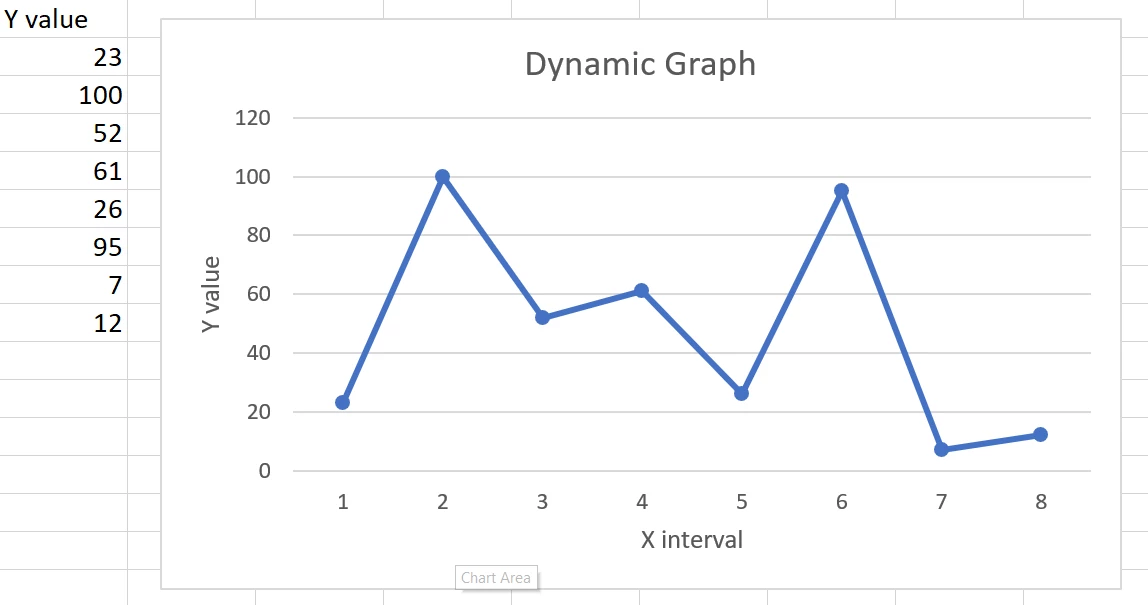

The dynamic graph widget allows me to add data points to the graph with a value of "Y" at fixed intervals of "X".
For example, with the graph below I provide the Y values which are then plotted at fixed intervals of X (in this example the fixed intervals of X are 1)
0693W000008GaAQQA0.pngThis works well for things like live sensor readings that are updated at regular intervals.

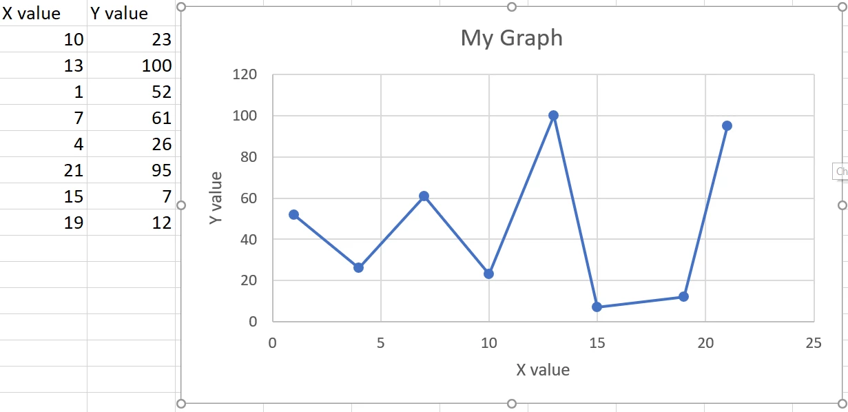

What I would like to do is plot a graph using a data set with X and Y values - like (X, Y) coordinates - where the X values are not just regular intervals.
For example, with the graph below I provide a set of X values and Y values which are then plotted as (X, Y) coordinates on the graph. As you can see the X values are not at fixed intervals, so the X value needs to be provided with the corresponding Y value to plot it in the correct place on the graph.
0693W000008GaLTQA0.pngI hope that clears us the question.

I'm looking exactly for the same thing! I think that basically, what we're looking for is a 'static graph' where one can specify the points they want to add.
It's a pitty that there's no such widget for the moment from what I've seen… Well, to be more exact, there is one (from version 10 if I'm not mistaken) but it's not an 'official' one that can be configured through the studio and many functionalities of the dynamic widget are missing… Plus it uses different objects to do the same thing (draw the line, fill the area below,…) so it would be a bit of a drag to use both the dynamic and static graphs in the same project… Do you plan to release such a widget in the future?
