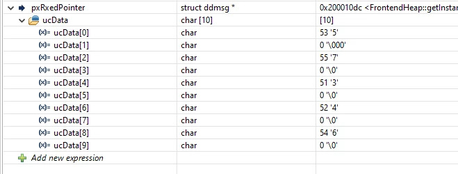

I am trying to get user input from the GUI to FreeRTOS. The text area buffer is transferred from my screen1View, to screen1Presenter, to model then added to a queue. Finally, my task in FreeRTOS will check for new data in the queue every 1 second.
The problem now is the received data. The user input in gui is 57346,the text area display this number correctly i.e. no space in between the numbers. But in my ucData[10] buffer, a 0 space exist in between the number i.e. 5070304060. How can I correctly transfer the user input to my main.c? Where is the cause for this ? Thank you!0693W000001reg7QAA.png

Your issue here may be that the input from the GUI is 16-bit unsigned while your tx buffer is char. Since your GUI input is in the ascii range, you can just discard the last 8-bits.
static void convertUnicodeToAscii(uint16_t* in, uint8_t* out)
 while(*in != 0)
 *out++ = (uint8_t)*in++;
 *out = 0;

I use Unicode to convert:
Unicode::fromUTF8((uint8_t*)function, textAreaFunctionBuffer, strlen(function));
In your case would be Unicode::toUTF8

Thanks you very much for your help @Martin KJELDSEN​  and @eng23​ . Your assumption is correct, after using the convertUnicodeToAscii function, it solved my problem!
