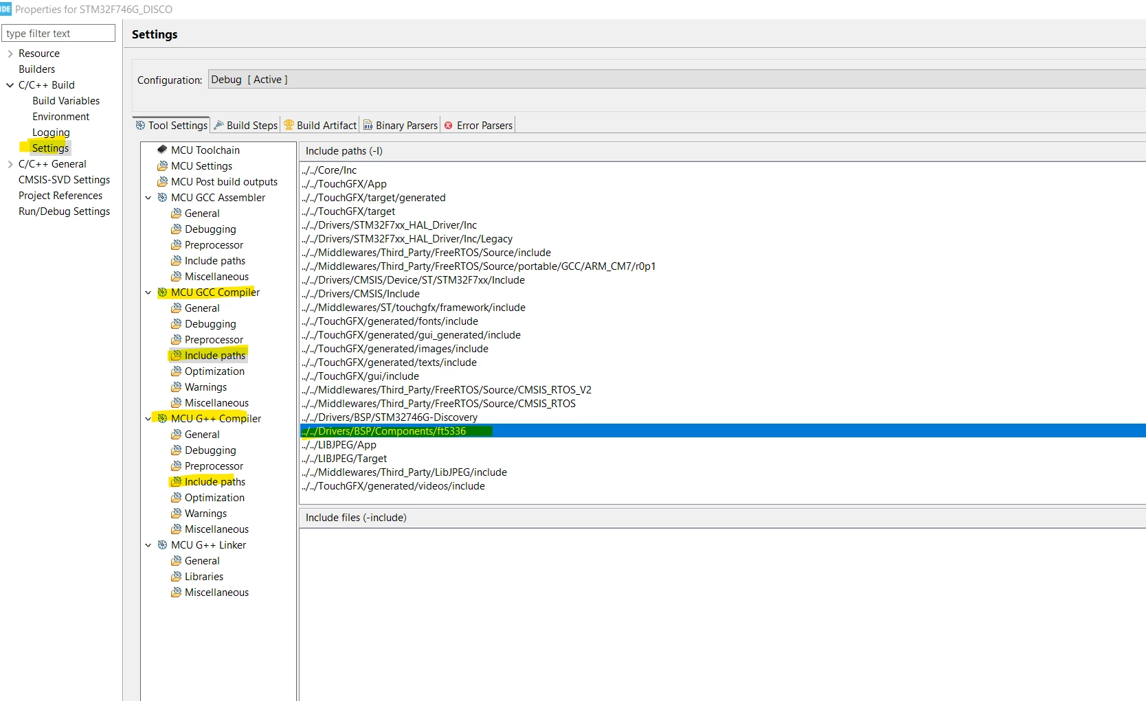

I can configurate the touchGFX configurator with the stm32f746, i can open the .part and designer some figures and bottoms, these yes appears in the LCD, i use the hardware stm32f746 discoveryboard.
But i no can active the function of the touch, have activate the I2C3 with 100khz, standard mode, as examples use the GFX Designer, but i no find put the FT5336  driver, or how i can configurete o call a these file autmatically ? i no understad how active the touch controller,

Did you include the path of your ft5336 driver?

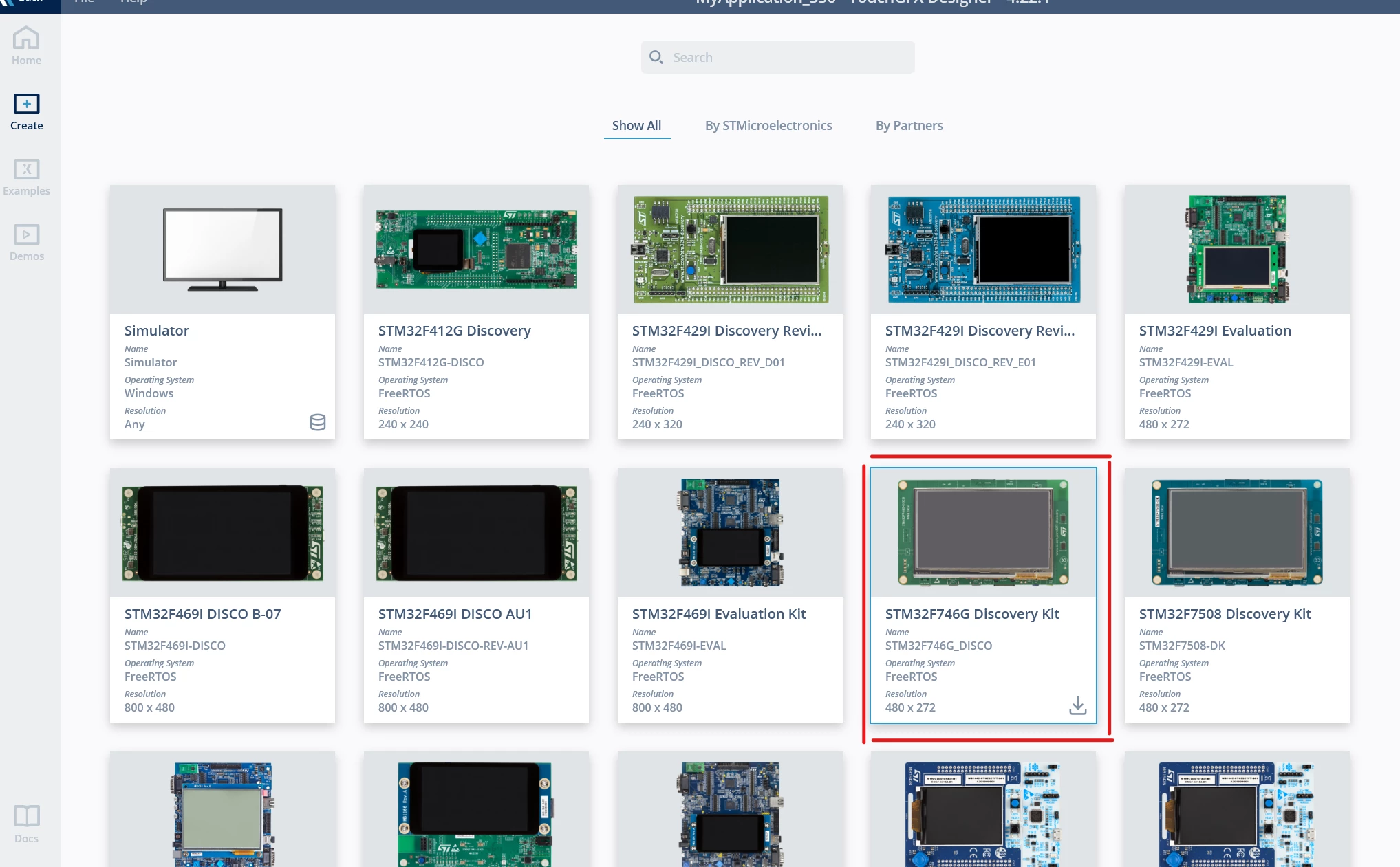

If you use an STM32F746G-Discovery board, we already provide a TBS that you can use without changing the driver or anything to enable touch screen.
Have you tried it?
RMasi.19
RMasi.19Author
Oct 10, 2023 1:47 PM UTC
Hi, yes i have probed the stm32F746 discovery kit, but i want practice with touchGFX generator and take the discoveryboard as if it were my design, i can generate images but the touch no work

Hello @RMasi.19 ,
RMasi.19
RMasi.19Author
Oct 12, 2023 1:24 AM UTC
Thank you, i can now activate the touch with touchgfx generator,

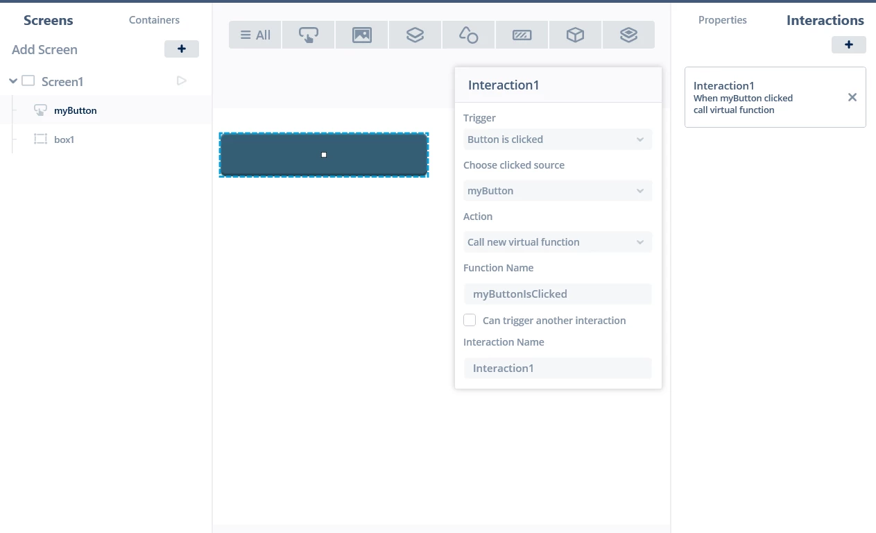

i now have two function in Screen1View.cpp, one for a button and other for aa toggle button:
void Screen1View::myPulsador1()
if( Pulsador1.getPressedState() ) HAL_GPIO_WritePin(GPIOI, GPIO_PIN_1, GPIO_PIN_SET);
else HAL_GPIO_WritePin(GPIOI, GPIO_PIN_1, GPIO_PIN_RESET);
//HAL_GPIO_TogglePin(GPIOI, GPIO_PIN_1);
void Screen1View::myToggleLed2()
if(toggleButton1.getState()) HAL_GPIO_WritePin(GPIOI, GPIO_PIN_1, GPIO_PIN_SET);
the function for toggle button work and PI1 is on/off, but function of button no activa the PI1, i know what enter here because when write the function togglePin yes active PI1 on/off. Maybe Pulsador1.getPressedState() no is the correct question, i think what it is the state of the button, some suggestion ?

I don't understand why you need a condition for your button. You just need to declare an interaction with as trigger : "Button is Clicked". Like this :
Then you can code that function in your Screen1View.cpp
void Screen1View::myButtonIsClicked()
I think it's simpler like that. Could you try that and tell us?
