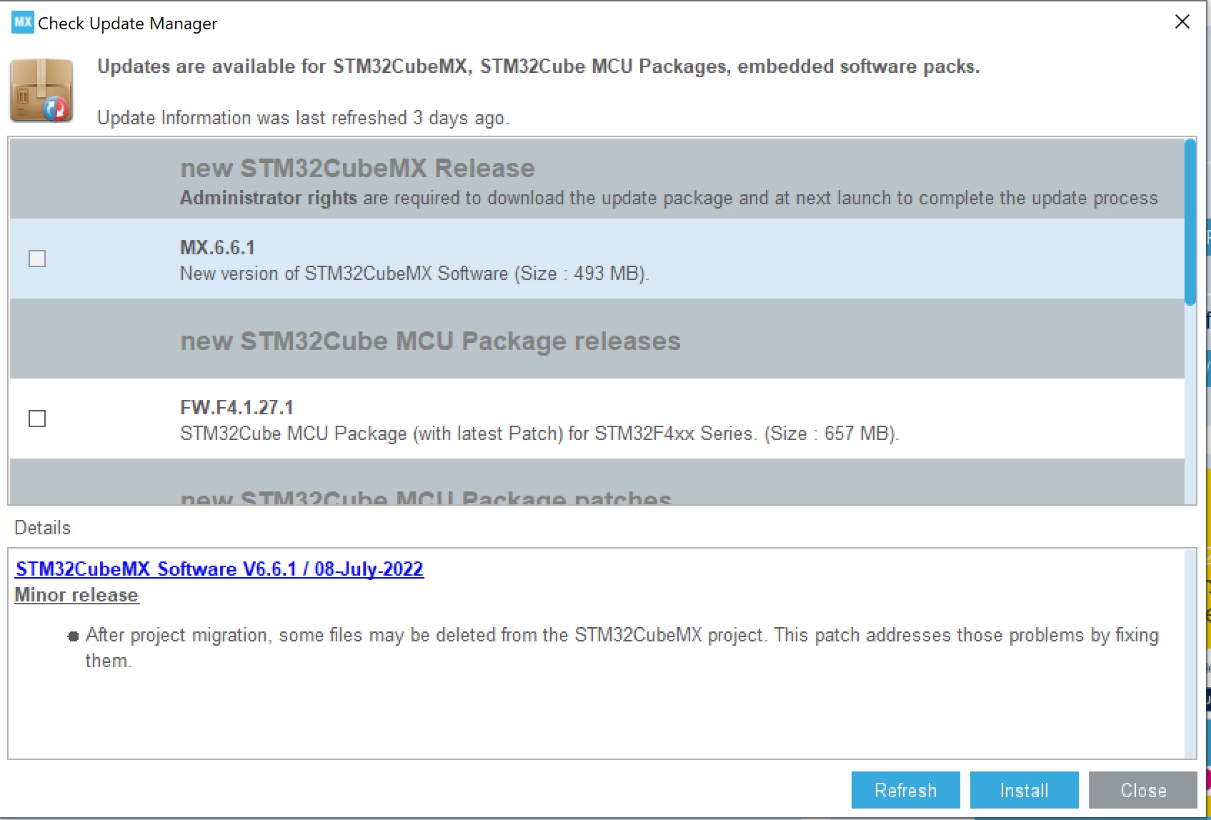

Hello @awiernie​ ,
I know that there was some issues with file deletion with CubeMX 6.6.0.
They just released version 6.6.1, can you try to regenerate with this one and let us know ?
Thank you,
/Yoann

Yoann KLEIN
Yoann KLEINBest answer
Jul 15, 2022 9:54 AM UTC
Hello @awiernie​ ,
Thank you,
/Yoann

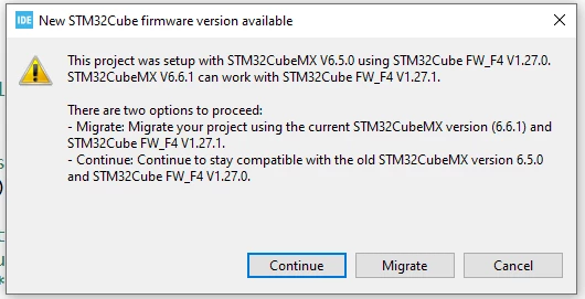

awiernie
awiernieAuthor
Jul 15, 2022 12:28 PM UTC
I had already installed 6.6.1, but I clicked continue (and not migrate):
0693W00000QLKXLQA5.pngNow I have migrated and the code was not erased - the TouchScreen works again.
