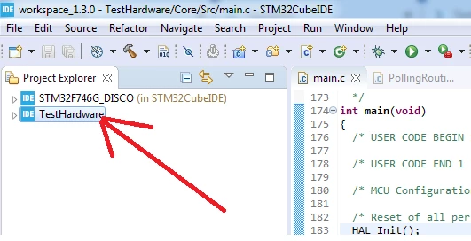

Karan 123
Senior
April 24, 2020
Your Project name may be Different ..
Please check below:
Karan
magicmarmot
April 24, 2020
Ah-- you're using the STM32CubeIDE. We're using Keil uVision.
