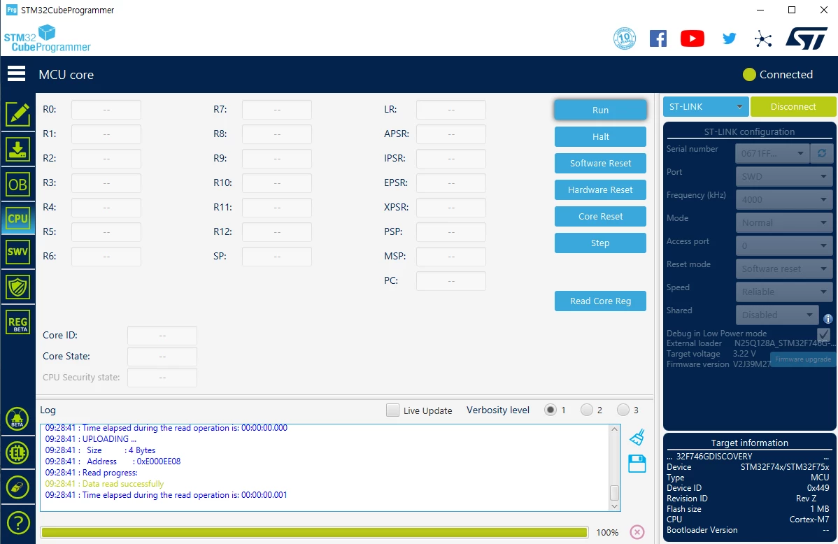

TouchGFX generated project is not worked on STM32F746G-DISCO(C01) (Only the "touch screen" doesn't work.)
I have the same problem as the link below.
(link : https://community.st.com/s/question/0D53W00001XM98mSAD/touchgfx-generated-project-is-not-worked-on-stm32f746gdiscoc01)
My board doesn't work with hardware reset, but it works with STM32CubeProgrammer.
0693W00000WIjV8QAL.pngWhat is the reason for this?

Yes.
After downloading the Hex file, press the reset button on the STM32F746G-DISCO, the screen appears. However, only the touch sensor is not working.
At this time, after executing the STM32CubeProgrammer, click the [Hardware RESET] , and click the [RUN] in MCU Core tab , then the touch sensor is working.
