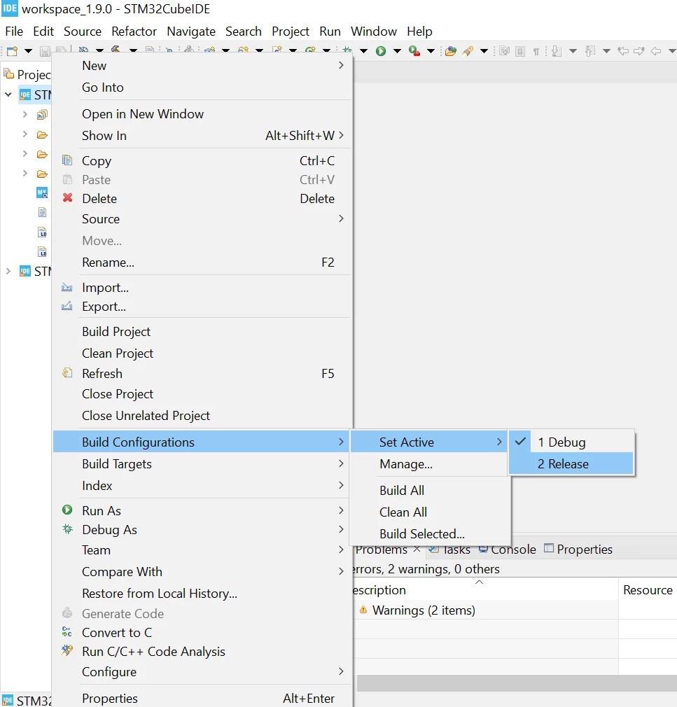

Can you share with us the error logs you have when you click on running on target with TouchGFX Designer ? Have you tried to run your project with release mode instead of debug mode within STMCubeIDE ?

As you told me, I tried building in release mode instead of debug mode, but it didn't work. (It looks that only the capacitive touch sensor is not working) The hex file at this time is also shared.

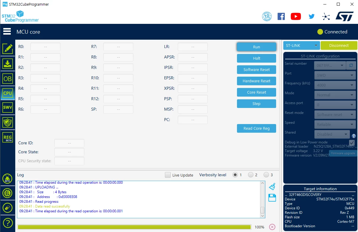

Also, as a new finding, clicking Run button in MCU Core tab from STM32CubeProgrammer worked fine. Is there anything in the boot sequence?

What about if you use STM32CubeProgrammer to download your program to your board ? Do you also have the issue ? (use the release and debug hex files to see if there's a difference). Also, did you try to unplug-plug your device to your computer after downloading the program ? (sometime the screen stay blank and needs a device reboot).

When I received the Run command from ST-LINK, it worked normally, but when I operated it with an external power supply or when I pressed the reset button on the board, the screen stopped and it did not work properly.
I took a video of using Cube Programmer, so I will send it.
