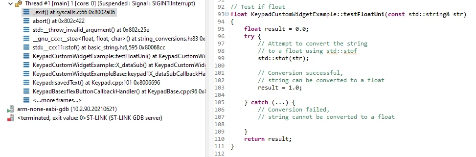

I use GCC but I found a solution using sscanf from this post : https://community.st.com/t5/stm32-mcus-products/floating-point-support-in-sscanf/td-p/429726
Thanks

Hello @JJame.1 ,
Exceptions can be use in your project's code but are not handled by default, and the TouchGfx library is not compiled with exceptions.
Can you tell me which ToolChain you are using?

Hi Louis,
