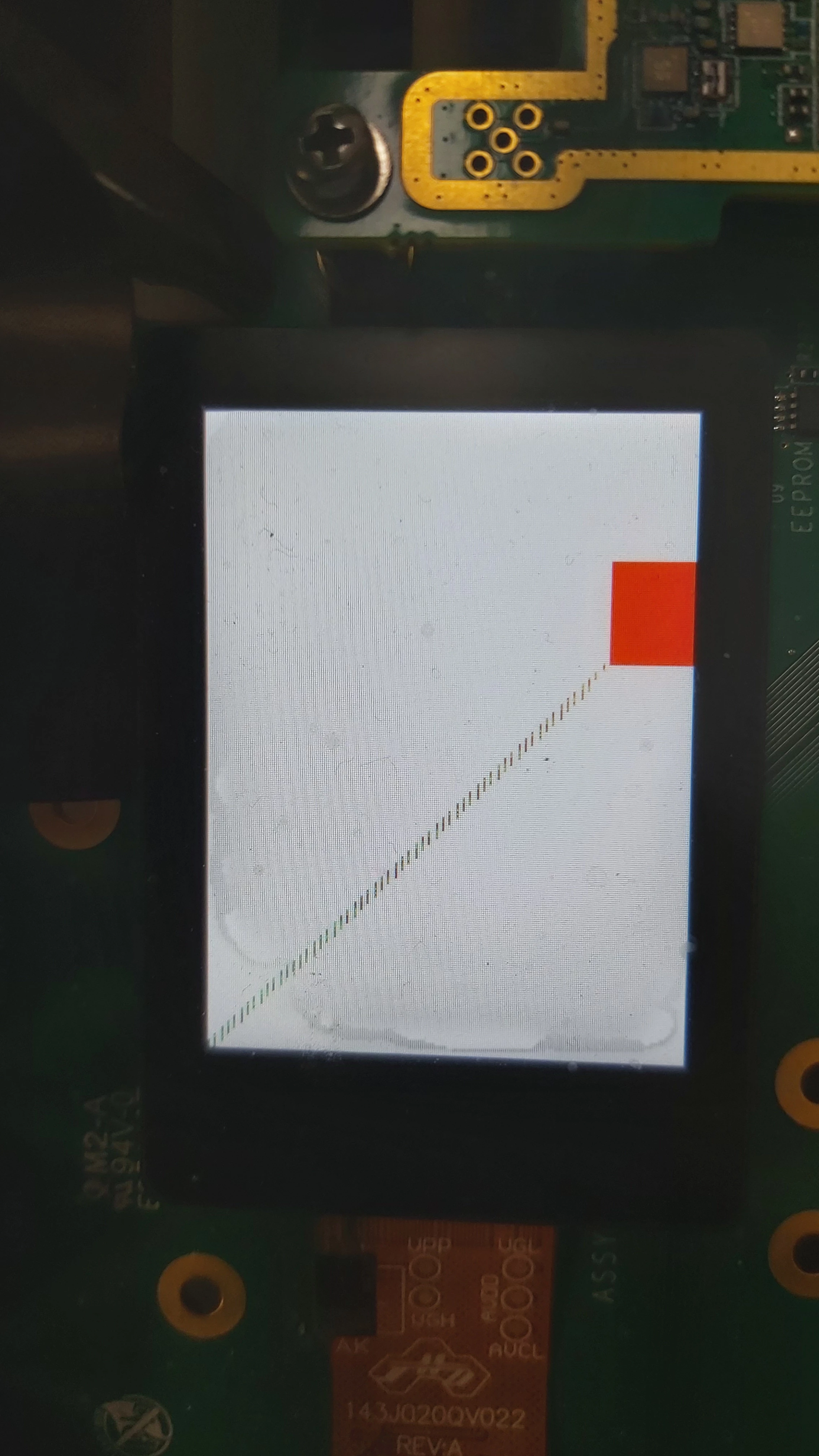

touchGFX function startMoveAnimation is leaving dots in the path. why ?

Hello, Oskt.
I declared the 320 width, 240 height in stm32cubemx for software-packs / touchGFX / display.
I didn't see any other place to set this.
in touchGFX config / display I see it as W 320 * H 240.
I didn't look for it in the IDE.
thanks. eyal.

Hello Eyal,
Indeed that would be enough. And what is the "Display Interface" configuration you have on STM32CubeMX ? LTDC, FMC ?
/Osman

hello, Oskt.
I set the display interface to Custom and added the file I have from the screen manufacture : st7789.c & .h .

Jun 8, 2022 2:30 PM UTC
I made changes to touchGFXHAL.cpp : copyFrameBufferBlockToLCD & flushFrameBuffer functions,
to be compatible to the st7789 I use.

Hello Eyal,
Have you tried to use other animations like screen transitions, fadeAnimation, changing box/screen color etc...
/Osman

hello, Oskt.
No, I didn't !

Jun 9, 2022 2:19 PM UTC
Ok, try with that, it will help us to see if it's a bug related to the animations or the screen itself.
Also, we have an article to check the display screen, you can have a look and try the example with changing the screen color.
