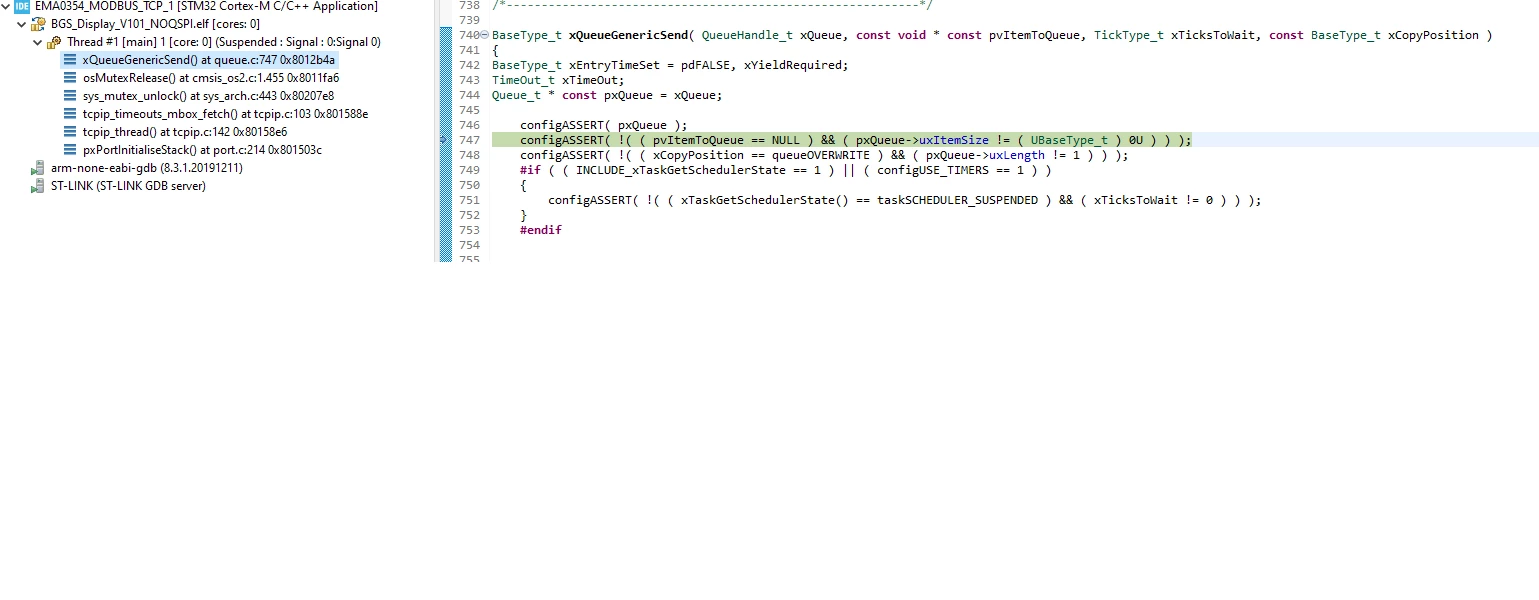

i checked your suggestions, and,  first tests was ok.
So I continued with development and added the ability to open a TCP port and exchange a small amount of data (for now, an echo of received data).
But something strange happens.
Sequence 1:
- program start
- I ping the address 2.1.1.1
- I open the port, send data, close the port.... and so on...
-> everything seems to be OK <--
Sequence 2:
- program start
- I open the port
Error !!  I can't open the port and the program goes into assertion as shown in the attached figure.
The only difference from sequence 1 and 2 it's that in the Nr.2 I don't ping the card...
Any other suggestions?

Dec 9, 2025 9:32 AM UTC
Have you tried enabling LwIP debug logs and increasing the verbosity? This will help you identify exactly where the error occurs.
Best regards

Then  I tried to simply connect to port 502. Then my program stuck and go in assert (screenshot3)
Screenshot 3
In screenshots 4 and 5 you can see the variables related to line that cause the assert:
As you can see, the code fall in assert becouse the variable xqueue->uxItemSize = 0x2400d224.
That memory position is part of allocated memory in heap_4.o module (part of freertos)
Here part of .map file
 0x0000000024001afc 0x4 ./Middlewares/Third_Party/FreeRTOS/Source/portable/GCC/ARM_CM4F/port.o
 .bss.ucHeap 0x0000000024001b00 0xbb80 ./Middlewares/Third_Party/FreeRTOS/Source/portable/MemMang/heap_4.o
 .bss.xStart 0x000000002400d680 0x8 ./Middlewares/Third_Party/FreeRTOS/Source/portable/MemMang/heap_4.o
 .bss.pxEnd 0x000000002400d688 0x4 ./Middlewares/Third_Party/FreeRTOS/Source/portable/MemMang/heap_4.o
The strange is that if I ping 2.1.1.1 then I connect to port the program don't fall on assert... (but I still see warning as in screenshot 2..)
Instead, if I connect to port without ping before, I always fall on asserts.
Pls. help me...my project 's blocked couse of that's strange things !!
