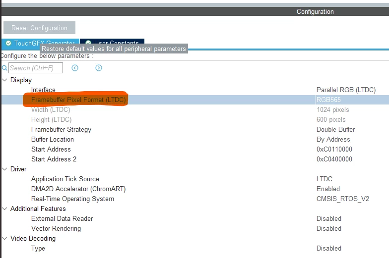

TouchGFX framebuffer pixel format(LTDC)
Is it possible to change TouchGFX framebuffer pixel format(LTDC) at runtime? If yes, how?

Hello @heyo ,
It's not possible to change the pixel format at runtime. Could I ask you why you want to change the pixel format at runtime?

My whole system works on RGB565 , but in main screen view I've got radient image which I want to change to RGB888 for better rendering. In RGB565 pixel format the lines are visible and the image is not quality.
I set RGB565 format for better experience because with RGB888 its lagging

Hello @heyo ,
I understand, have you tried to change the Dither Algorithm? Maybe it can help you to make your image look better.
