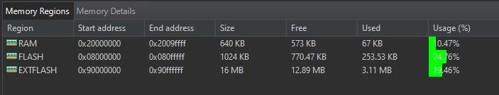

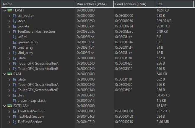

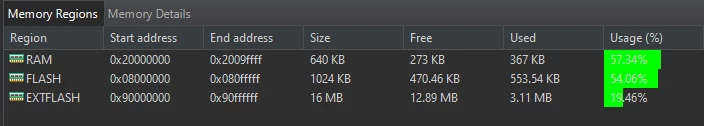

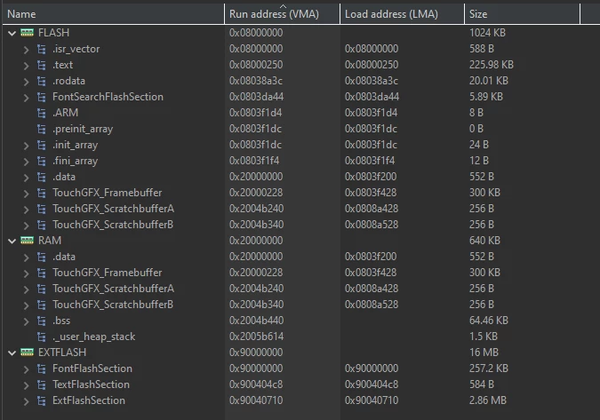

PFlor.2
PFlor.2Author
Senior II
Jan 13, 2025 3:27 PM UTC
Thanks for the tip but I started that way and it appears that Flash memory is taken with this approach, by address does not utilize the flash space like by allocation does.  Can you advise on this?
By Allocation:
By Address:

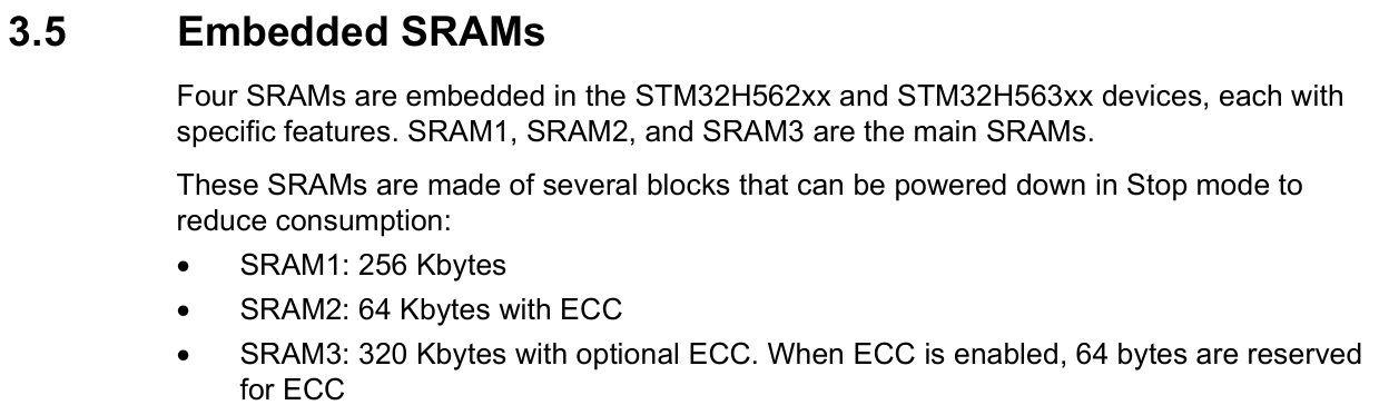

MM..1
Jan 13, 2025 4:26 PM UTC
If you choice by address, then linker script require reservations for this, for example
RAM  0x20000000 256k
RAMFB 0x20040000 ...
but as i show you better is use maybe RAM3
And by allocation result to init in flash when you dont mark it as noinit... result same size in flash and ram.
GaetanGodart
GaetanGodartBest answer
Jan 17, 2025 9:28 AM UTC
Hello @PFlor.2 ,
This code (talking about the NOLOAD)
prevents the framebuffer section from being loaded into the ram at startup.
Is it what you were asking?
Regards,
Gaetan GodartSoftware engineer at ST (TouchGFX)
