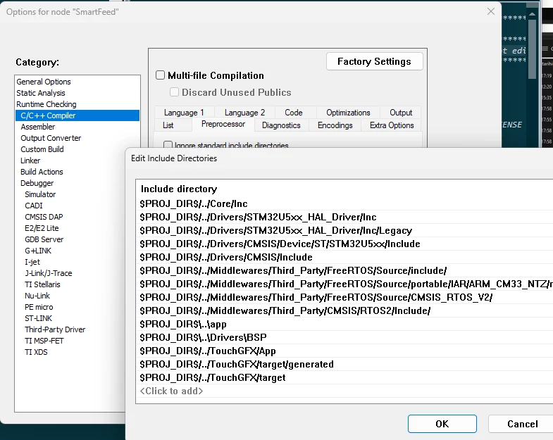

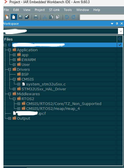

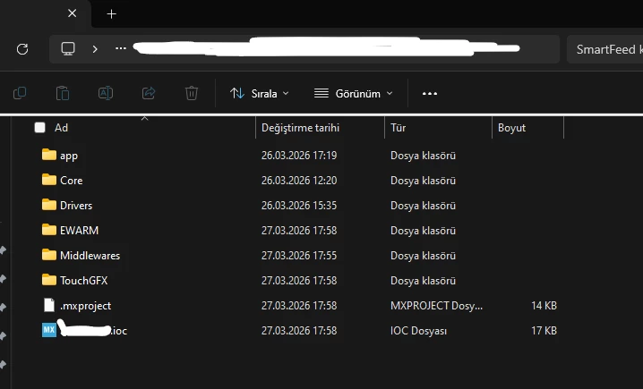

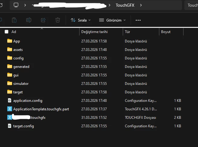

I created project from Cube, than I double clicked touchgfx file under TOUCHGFX folder.I created a dummy project with only a red box and I clicked generate code on TouchGFX as I always do. But when I open IAR project I cannot see TouchGFX folder on IAR workspace window  and when I try to build project, IAR gives a lot of erros about not founded Touchgfx files.  Touchgfx files and folders ara exist in my project folder but not in IAR workspace window.
