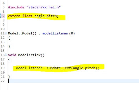

Hi, how can I do if I want to display the float value in touchgfx screen?
so, this is my stm32cubeide main.c which i want to display this type of data on the screen.
then I put the float value here? I got confuse since a lot of tutorial only using the uint16_t.0693W00000Y7F3UQAV.png
Is it correct or not ? please advice me and guide me for the step or any can i refer

Hello @Angle​ ,
@ktrofimo​ is right, the best solution for that is to use Unicode::​snprintfFloat() method with wildcards in a TextArea for example.
/Yoann
