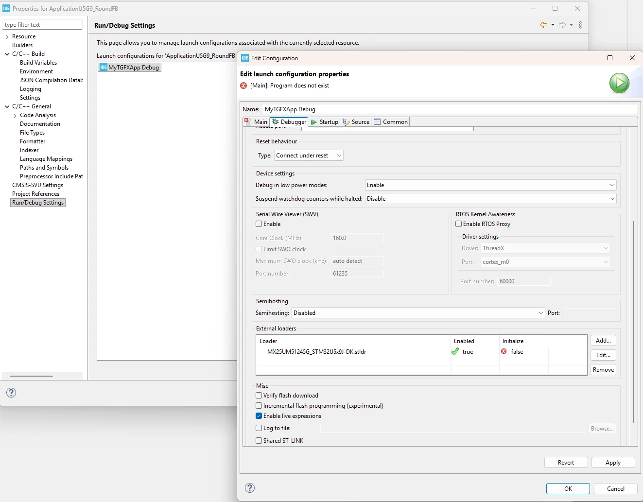

I use STM32G4 series. I have an external loader with a starting address of 0xA0000000. I can perform read and write operations with this loader using CubeProgrammer. However, when I define the external loader via CubeIDE, it programs the address 0x080000000. Then I get Hard Fault.

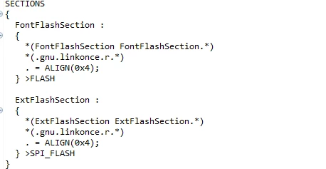

Here is my flash.ld

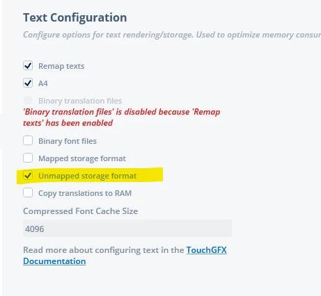

Also my second problem is texts. My text datas are sending to external flash, but it is not appear. Then I changed font section to internal flash in flash.ld, my text was appear.
Here is my changed sections side.
The textures are changing because something else is changing. Why isn't the screen showing the text I added with the external loader?

For your first issue, I believe the STM32CubeIDE is probably not using the correct external loader.
Could you check you have the correct loader by going to your project properties->Run/Debug Settings->Debugger → External Loaders
For your second question, I’d recommend you to change in your linker file the part for FontFlashSection to be placed in SPI_FLASH instead of FLASH .
FontFlashSection :
*(FontFlashSection FontFlashSection.*)
*(.gnu.linkonce.r.*)
. = ALIGN(0x4);
} >SPI_FLASH
Also don’t forget to select Unmapped storage format in your Text Configuration in TouchGFX Designer.

Mr. Osman thanks for reply.
The solution is unmapped storage format. Before your reply, i found in this link;
Using Non-Memory Mapped Flash for Font Data | TouchGFX Documentation
I implemented unmapped storage format to appear texts. It works !
I change the starter address for my project. I done it too.
