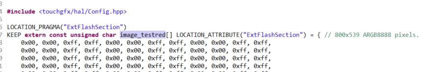

My test png is full Red (#FF0000) and I am adjusting its image format to ARGB8888 from touchgfx. When I build the project touchgfx converting this png to an auto-generated cpp file as follows:

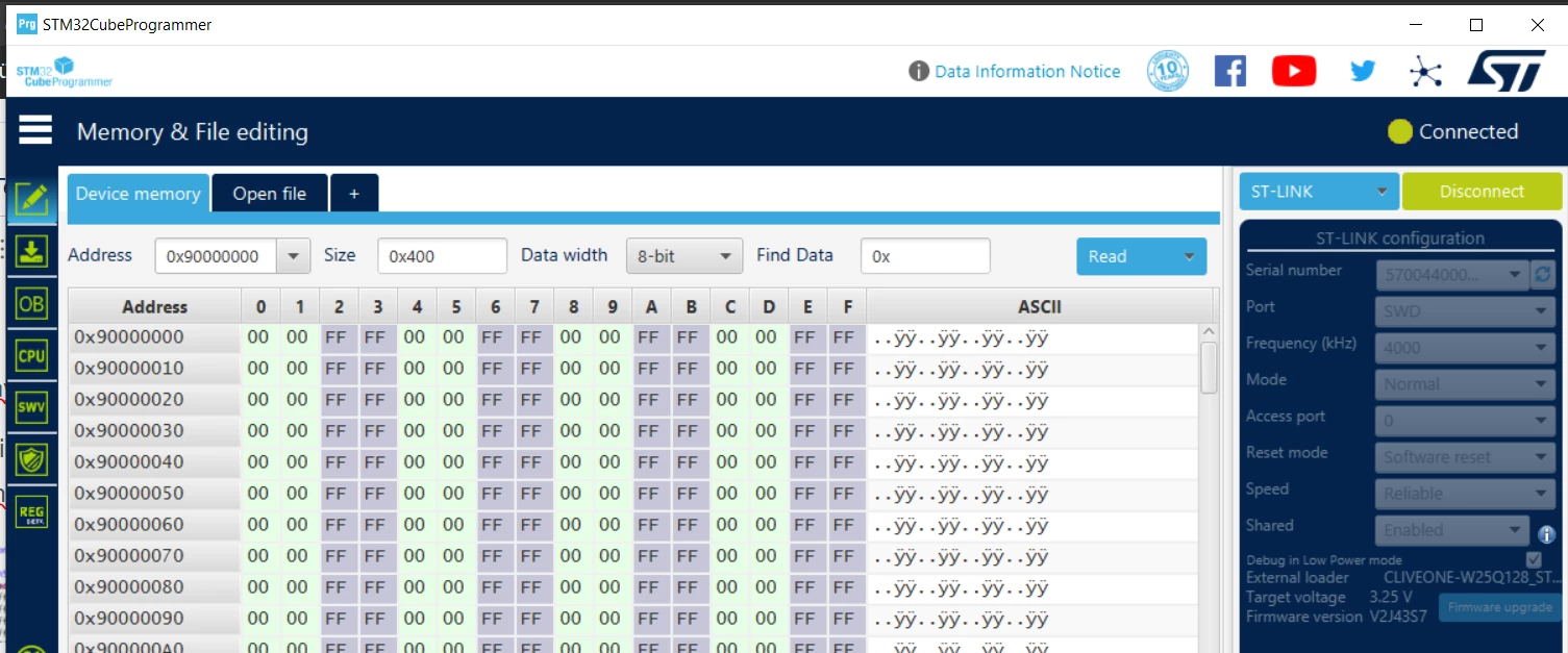

Then I download the code with CubeMXProgrammer and read back the 0x90000000 which is mapped to QSPI external flash. The representation of the png in the flash is as follows:

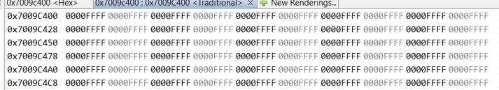

The CPP file and the flash contents seems overlapped to me. And when I run the code and read the frame buffer:
It is still overlapping. But I am seeing color of CYAN instead of RED.
