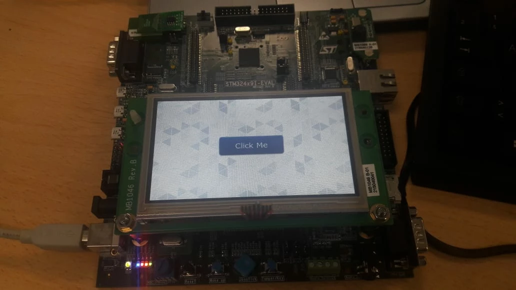

Yes i agree with you, i migrated to Attolic TrueStudio and it work better and without error,
Now i can display my GUI on my eval board without any limitations.
I'm working now on a tutorial and i'll shared it in this community :) *
