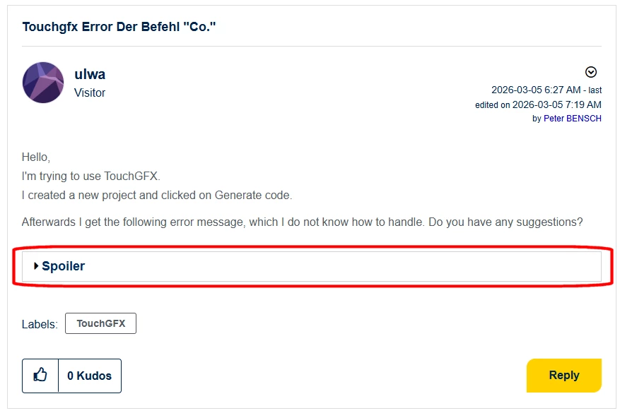

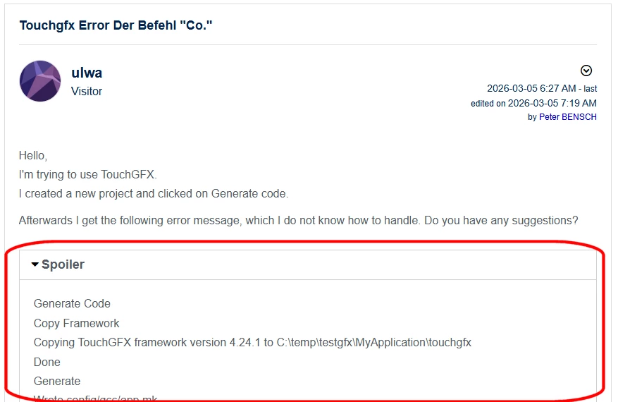

I'm trying to use TouchGFX.
I created a new project and clicked on Generate code.
Afterwards I get the following error message, which I do not know how to handle. Do you have any suggestions?
Generate Code
Copy Framework
Copying TouchGFX framework version 4.24.1 to C:\temp\testgfx\MyApplication\touchgfx
Done
Generate
Wrote config/gcc/app.mk
Wrote config/msvs/Application.props
Wrote generated/gui_generated/include/gui_generated/common/FrontendApplicationBase.hpp
Wrote generated/gui_generated/include/gui_generated/common/FrontendHeapBase.hpp
Wrote generated/gui_generated/include/gui_generated/common/SimConstants.hpp
Wrote generated/gui_generated/include/gui_generated/screen1_screen/Screen1ViewBase.hpp
Wrote generated/gui_generated/src/common/FrontendApplicationBase.cpp
Wrote generated/gui_generated/src/screen1_screen/Screen1ViewBase.cpp
Wrote generated/simulator/gcc/Makefile
Wrote generated/simulator/include/simulator/mainBase.hpp
Wrote generated/simulator/include/simulator/video/DirectFrameBufferVideoController.hpp
Wrote generated/simulator/include/simulator/video/MJPEGDecoder.hpp
Wrote generated/simulator/include/simulator/video/SoftwareMJPEGDecoder.hpp
Wrote generated/simulator/msvs/touchgfx_prebuild.targets
Wrote generated/simulator/msvs/touchgfx_sdl2.props
Wrote generated/simulator/msvs/touchgfx.props
Wrote generated/simulator/src/mainBase.cpp
Wrote generated/simulator/src/video/SoftwareMJPEGDecoder.cpp
Wrote generated/simulator/touchgfx.ico
Wrote generated/simulator/touchgfx.rc
Wrote generated/simulator/touchgfx.res
Wrote generated/user.config
Wrote gui/include/gui/common/FrontendApplication.hpp
Wrote gui/include/gui/common/FrontendHeap.hpp
Wrote gui/include/gui/model/Model.hpp
Wrote gui/include/gui/model/ModelListener.hpp
Wrote gui/include/gui/screen1_screen/Screen1Presenter.hpp
Wrote gui/include/gui/screen1_screen/Screen1View.hpp
Wrote gui/src/common/FrontendApplication.cpp
Wrote gui/src/model/Model.cpp
Wrote gui/src/screen1_screen/Screen1Presenter.cpp
Wrote gui/src/screen1_screen/Screen1View.cpp
Wrote simulator/gcc/Makefile
Wrote simulator/main.cpp
Wrote simulator/msvs/Application.sln
Wrote simulator/msvs/Application.vcxproj
Wrote simulator/msvs/Application.vcxproj.filters
Wrote target.config
Done
Generate Assets
make -f simulator/gcc/Makefile assets -j8
Der Befehl "Co." ist entweder falsch geschrieben oder
konnte nicht gefunden werden.
Failed
Failed

Why did you put the output log in a 'Spoiler' tag?
